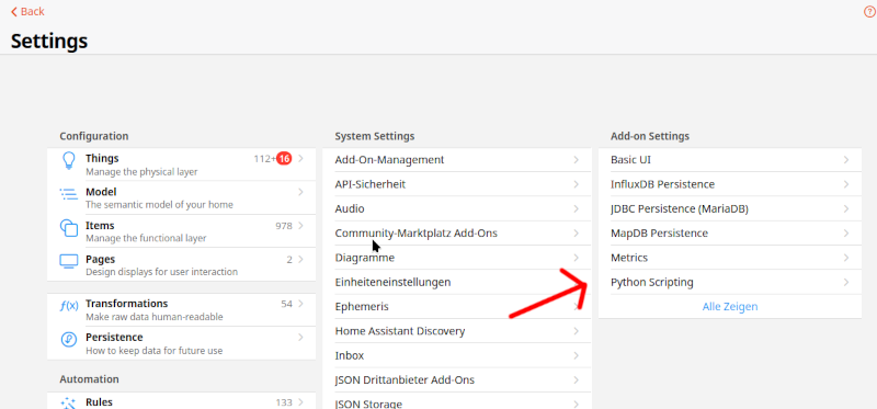

Web based config dialog can be found via Web UI => Settings / Add-on Settings / Python Scripting

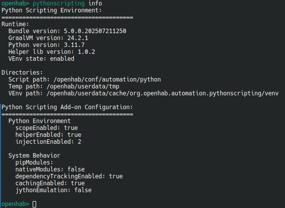

The openHAB Console (opens new window) provides access to additional features of these Add-on.
pythonscripting infois showing you additional data like version numbers, activated features and used path locations

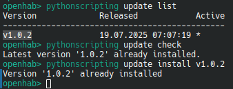

pythonscripting updateallows you to check, list, update or downgrade your helper lib

- Login into openHAB console (opens new window) and check your current pythonscripting environment by calling
Important values are:
GraalVM version: 25.0.1VEnv path: /openhab/userdata/cache/org.openhab.automation.pythonscripting/venv
These values are needed during the next step

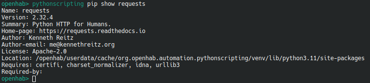

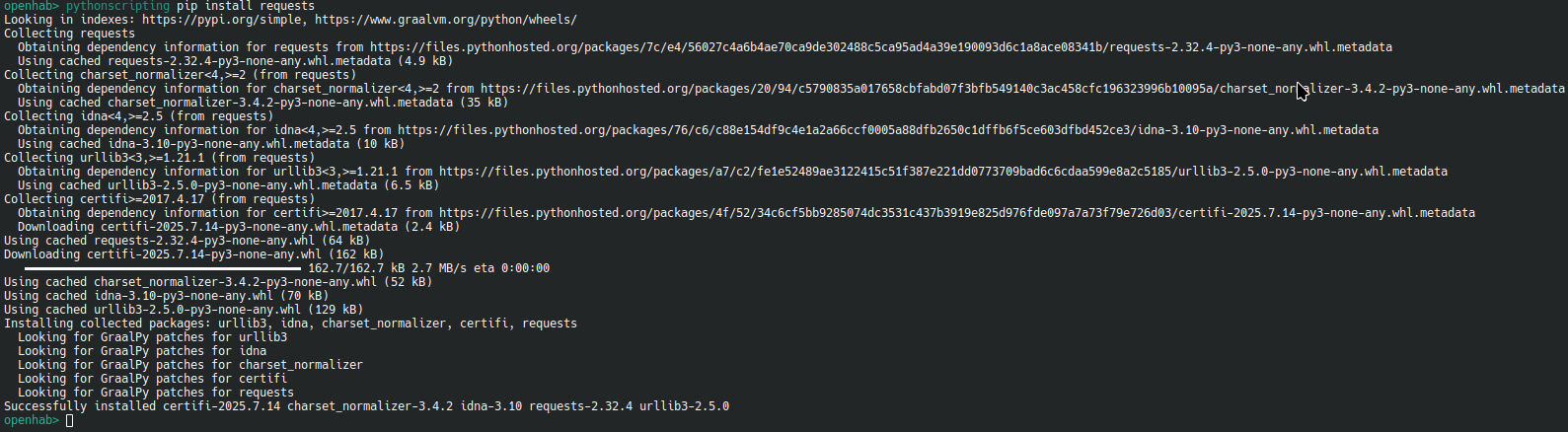

# Using pip to install external modules
As first, you must enable VEnv. After this is enabled, you can use pip in 2 ways.
Using the pythonscripting console
Using venv pip on your host system
/openhab/userdata/cache/org.openhab.automation.pythonscripting/venv/bin/pip install requests

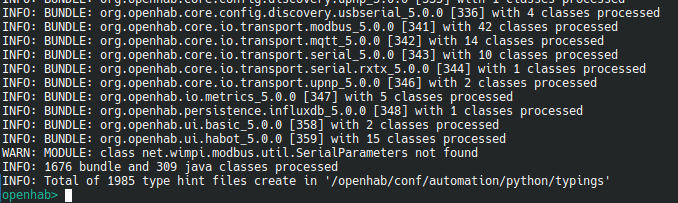

# Enable Python Autocompletion
Before you can enable autocompletion, you must generate the required type hint stub files. Login into openHAB console (opens new window) and run
pythonscripting typing
This will scan your current openHAB instance, including all installed Add-ons, for public java class methods and create corresponding python type hint stub files.
The files are stored in the folder /openhab/conf/automation/python/typings/.
As a final step, the folders /openhab/conf/automation/python/libs/ and /openhab>/conf/automation/python/typings/ must be added as "extraPaths" in your IDE.
