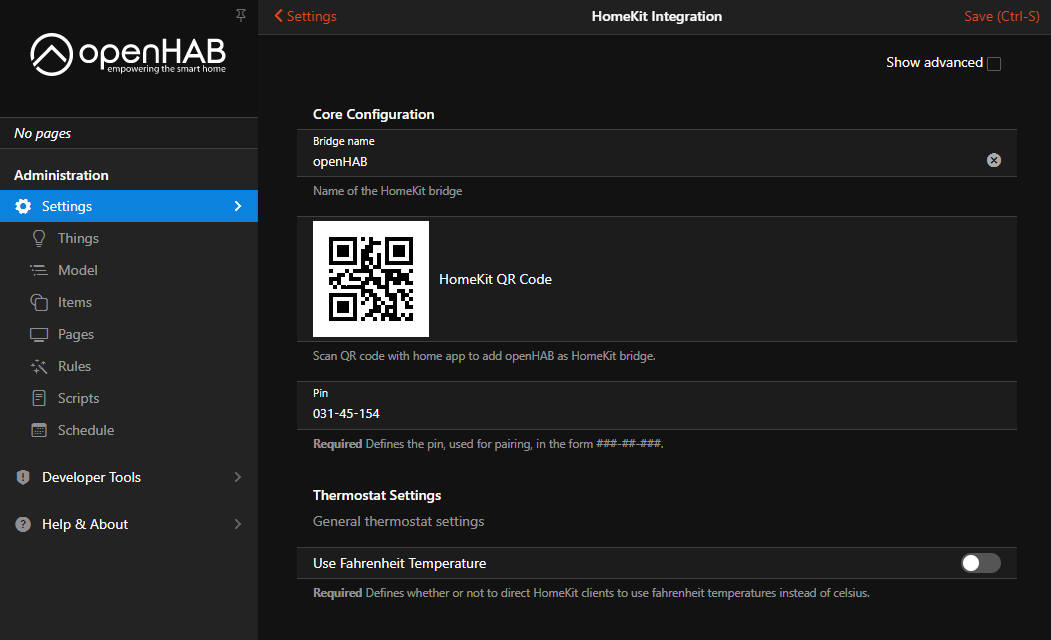

# Quick start
  • install homekit addon via UI
  • add metadata to an existing item (see UI based configuration)

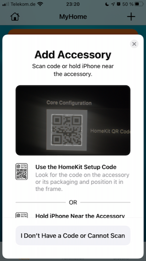

  • scan QR code from UI->Settings->HomeKit Integration

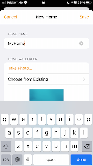

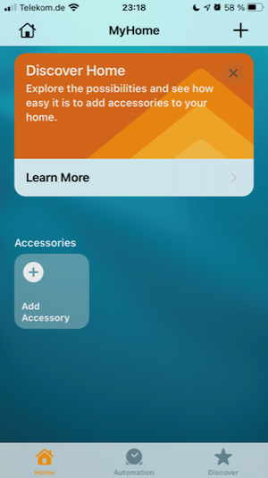

  • open Home app on your iPhone or iPad
  • create new home
  • add accessory
  • scan QR code from UI->Setting-HomeKit Integration
  • click "Add Anyway"
  • follow the instruction of the Home app wizard
Add metadata to more items or fine-tune your configuration using further settings
# Global Configuration
You can define HomeKit settings either via mainUI or via $OPENHAB_CONF/services/homekit.cfg. HomeKit works with default settings, but we recommend changing the pin for the bridge. This will be used in iOS when pairing without QR Code. The pin code is in the form "###-##-###". Requirements beyond this are not clear, and Apple enforces limitations on eligible pins within iOS. At the very least, you cannot use repeating (111-11-111) or sequential (123-45-678) pin codes.
Other settings, such as using Fahrenheit temperatures and specifying the interface to advertise the HomeKit bridge are also illustrated in the following sample:
org.openhab.homekit:port=9123
org.openhab.homekit:pin=031-45-154
org.openhab.homekit:useFahrenheitTemperature=true
org.openhab.homekit:networkInterface=192.168.0.6
org.openhab.homekit:useOHmDNS=false
org.openhab.homekit:blockUserDeletion=false
org.openhab.homekit:name=openHAB
org.openhab.homekit:instances=1
org.openhab.homekit:useDummyAccessories=false
Some settings are only visible in UI if the checkbox "Show advanced" is activated.

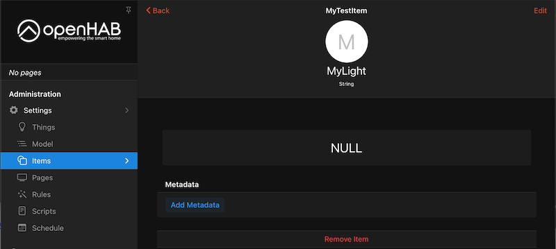

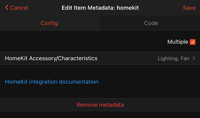

# UI based Configuration
In order to add metadata to an item:
  • select desired item in mainUI
  • click on "Add Metadata"
  • select "Apple HomeKit" namespace
  • click on "HomeKit Accessory/Characteristic"
  • select required HomeKit accessory type or characteristic
  • click on "Save"

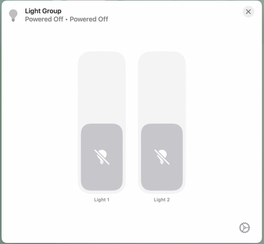

Alternatively, you may want to have a choice of controlling the items individually, OR as a group, from HomeKit. The following examples defines a single HomeKit accessory with multiple services that the Home app will allow you to control together, or drill down and control individually. Note that AccessoryGroup doesn't expose any services itself, but allows you to group other services together underneath it. Also note that when nesting accessories, you cannot use the shorthand of naming only a characteristic, and not its accessory type, since it would be ambiguous if that item belongs to a secondary service, or to the primary service it's nested under.
Group:Switch:OR(ON,OFF) gLight "Light Group" {homekit="AccessoryGroup"}
Switch light1 "Light 1" (gLight) {homekit="Lighting"}
Switch light2 "Light 2" (gLight) {homekit="Lighting"}
Group of Lights

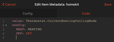

These modes are mapped to string values of openHAB items using configuration at the item level. e.g. if your current mode item can have following values: "OFF", "HEATING", "COOLING" then you need following mapping at item level
String          thermostat_current_mode     "Thermostat Current Mode" (gThermostat) {homekit = "CurrentHeatingCoolingMode" [OFF="OFF", HEAT="HEATING", COOL="COOLING"]}
You can provide mapping for target mode in a similar way.
The custom mapping can be also used to reduce number of modes shown in Home app. The modes can be only reduced, but not added, i.e. it is not possible to add a new custom mode to HomeKit thermostat.
Example: if your thermostat does not support cooling, then you need to limit mapping to OFF and HEAT values only:
String          thermostat_current_mode    "Thermostat Current Mode"            (gThermostat) {homekit = "CurrentHeatingCoolingMode" [HEAT="HEATING", OFF="OFF"]}
String          thermostat_target_mode     "Thermostat Target Mode"             (gThermostat) {homekit = "TargetHeatingCoolingMode" [HEAT="HEATING", OFF="OFF"]}
The mapping using main UI looks like following:

# openHAB is not listed in Home app
if you don't see openHAB in the Home app, probably multicast DNS (mDNS) traffic is not routed correctly from openHAB to Home app device or openHAB is already in paired state. You can verify this with Discovery DNS iOS app (opens new window) as follow:
  • install discovery dns app from app store
  • start discovery app
  • find _hap._tcp in the list of service types
  • if you don't find _hap._tcp on the list, probably the traffic is blocked.
    • to confirm this, check whether you can find _openhab-server._tcp. if you don't see it as well, traffic is blocked. check your network router/firewall settings.
  • if you found _hap._tcp, open it. you should see the name of your openHAB HomeKit bridge (default name is openHAB)
  • if you don't see openHAB bridge name, the traffic is blocked
  • if you see openHAB HomeKit bridge, open it
  • verify the IP address. it must be the IP address of your openHAB server, if not, set the correct IP address using networkInterface settings
  • verify the flag "sf".
    • if sf is equal 1, openHAB is accepting pairing from new iOS device.
    • if sf is equal 0 (as on screenshot), openHAB is already paired and does not accept any new pairing request. you can reset pairing using openhab:homekit clearPairings command in karaf console.
  • if you see openHAB bridge and sf is equal to 1 but you dont see openHAB in the Home app, the Home app probably still thinks it is already paired with openHAB. remove your home from the Home app and restart the iOS device.
