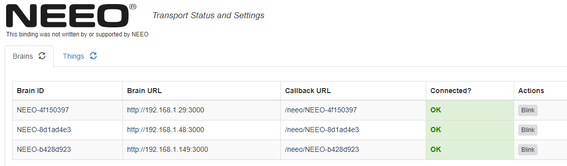

# Brains Tab
The Brains tab provides a listing of all NEEO brains that have been found, some information about them and their current status (connected or not).
If your brain has not been discovered, you may manually enter the brain by pressing the "Add Brain" button. You will be prompted for the Brain's IP address and once entered, the brain should be listed in the resulting table.

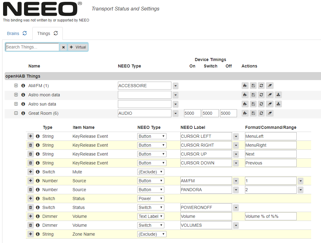

# Things Tab
The Things tab is where you specify the mappings.
There are two types of devices listed here:
  1. openHAB things - any OH2 thing in the openHAB system and optionally (see configuration), any NEEO binding thing.
  2. virtual things - these are things you defined that can mix/match any OH1 or OH2 item.
openHAB things can be mapped to a NEEO device and the items within the thing can be mapped to NEEO device capabilities (buttons, lists, switches, sliders, etc). Virtual things represent a 'thing' that doesn't exist in openHAB but that you would like to define as a NEEO device. You can then add OH1/OH2 items to that virtual thing and those items will be mapped to a NEEO device capabilities.
There are two types of items supported:
  1. Any valid openHAB item (OH1 or OH2).
  2. Trigger channels - any trigger channel defined in an openHAB thing or any trigger channel that you add to an existing thing (regardless if it is an openHAB thing or a virtual thing).
Trigger channels are useful to add to an existing thing if you want to add a button on NEEO that when pushed, can perform some rule that you have defined on a trigger.
Please review NEEO SDK (opens new window) documentation before attempting to map. This document describes some (but not all) of the requirements for NEEO things and capabilities. The NEEO SDK document is written from the perspective of writing native plugins for NEEO but much of its concepts apply here.
Mappings consist of two parts:
  1. Mapping of an openHAB thing to a NEEO device or the creation of a new virtual thing.
  2. Mapping of an openHAB item or trigger channels to one or more NEEO capabilities.
Please see this screen shot for reference to the next two sections. This screen show partially shows the setup of my Russound (whole house music system): Configuration

# Thing to Device
The first step in mapping is to map an openHAB thing to a NEEO device type. You may either choose an existing openHAB item or create a new 'virtual' thing by pressing the "+ Virtual" button and assign a name to it.
The following action can then be performed:
  1. Press the "+" (or "-") icon to see/hide the items for the thing.
  2. Press the "i" button to see information about the thing (online status, etc).
  3. [Virtual things] Modify the device name.
  4. Specify or choose the NEEO device type for the openHAB thing.
  5. [Virtual things] Press the "+" icon to add new items to the device.
  6. Press the puzzle piece icon to add new trigger channel to the device.
  7. Press the SAVE icon to save the mapping for the openHAB thing.
  8. Press the REFRESH icon to refresh the mapping to the last saved state (discarding any pending changes).
  9. [openHAB things] Press the RESTORE icon to restore the mapping to its original content (discarding any pending changes).
  10. [Virtual things] Press the DELETE icon to delete the thing.
  11. [things with trigger channel(s)] Press the RULES icon to download an example .rules file for the triggers.
  12. [NON ACCESSORIE/LIGHT] Specify device timings (see below).
The list of device types is unknown, must match those that NEEO expects (such as "ACCESSORIE", "AUDIO", etc) and you have the ability to enter the device type directly or select from a list of device types that have been discovered (although all may not be functional on the NEEO brain yet). Please review the NEEO SDK documentation for hints on what device types are supported and what capabilities are supported by each device type.
Please note that "ACCESSORIE" is not a misspelling. That is how the NEEO brain expects it. You may specify a type of "ACCESSORY" when defining a new type, but after saving - the type will switch back to "ACCESSORIE"

In the example screen shown above:
  1. The Russound AM/FM tuner was mapped to an "ACCESSORIE" NEEO type.
  2. The Russound Great Room zone was mapped to an "AUDIO" device (to allow volume keys to work).
