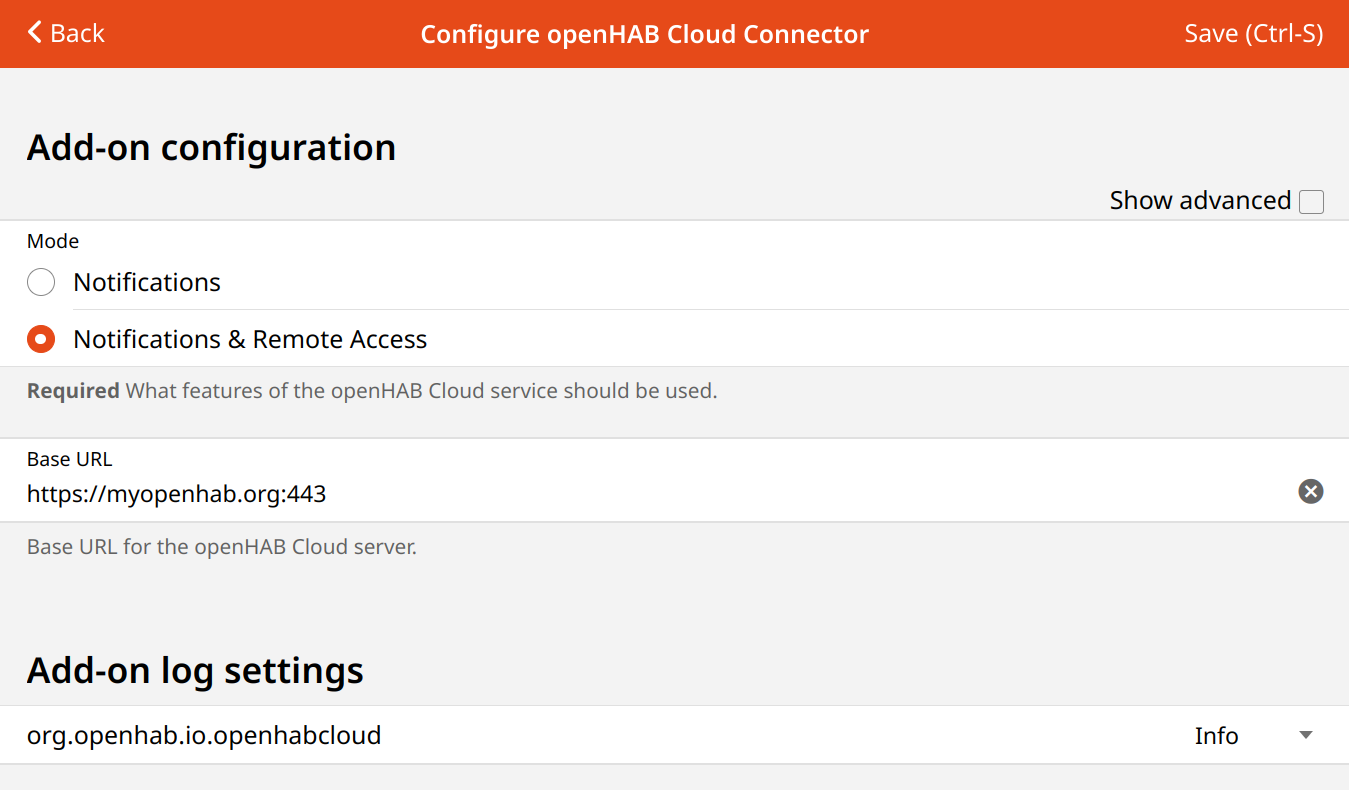

# Configuration
After installing this add-on, you will find configuration options in the openHAB portal under Settings -> Add-on Settings -> openHAB Cloud Connector:
Configuration
By default, both remote access and push notifications are enabled.

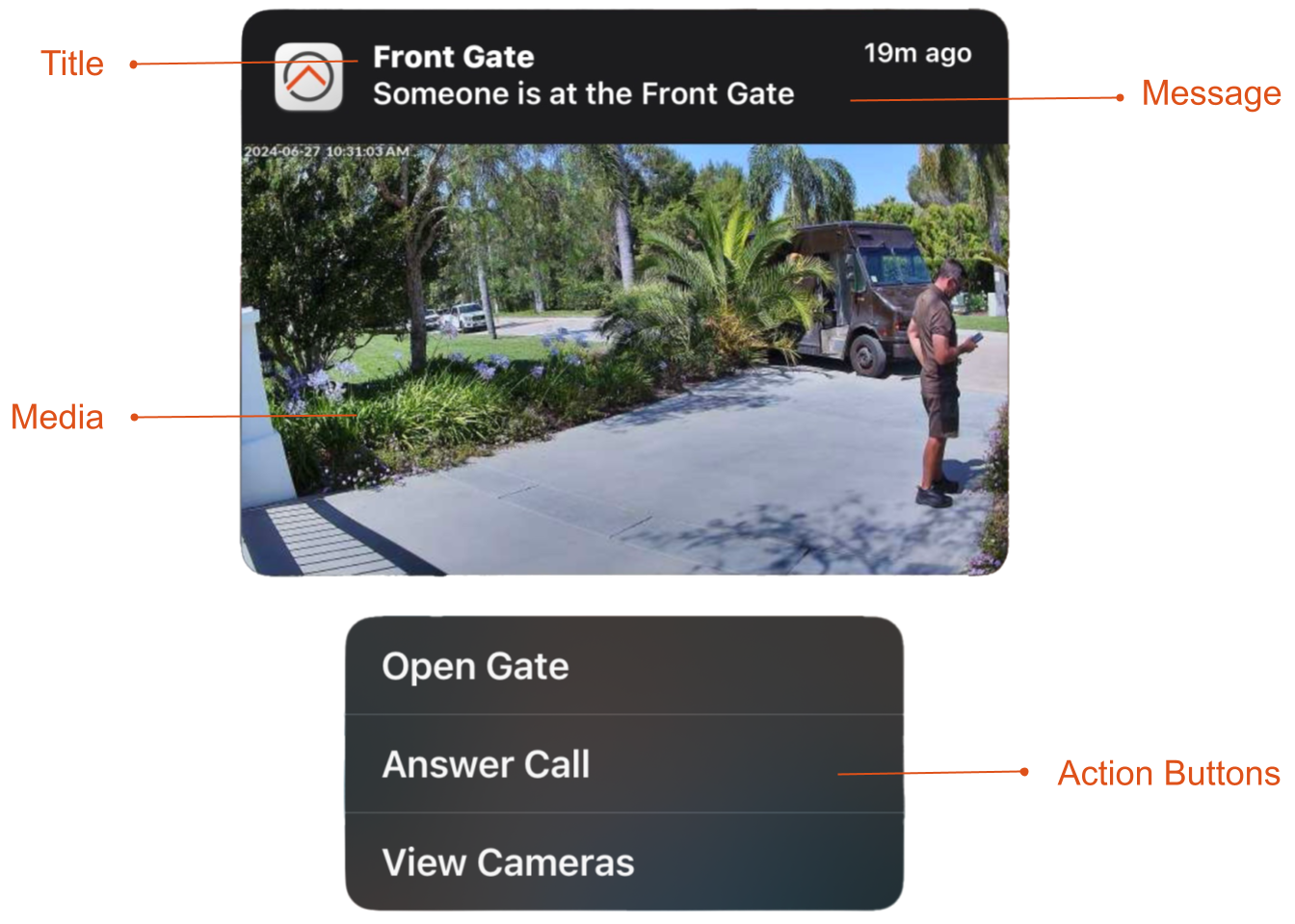

# Title, Tag, Reference Id, Media Attachments & Actions
The sendNotification and sendBroadcastNotification actions additionally support setting a title, reference id, media attachments and actions.
  • The tag is used for tagging messages for grouping when displaying in the app and to hide/remove groups of messages from a user's device. Tag was previously referred to as "severity".
  • The title is displayed as the notification title on the device and defaults to "openHAB" for the Android and iOS apps.
  • The reference id is a user supplied identifier that when set will replace messages with the same id on the user's device (so only the last version exists). It can be used to update or remove notifications.
  • Media attachments are displayed together with the notification on the device and can be used to display images, e.g. a camera snapshot.
  • Actions allow the user to interact with the notification, e.g. to open a specific page in the app or to send a command to an Item.
There are four different actions available:
  • Click action: Is performed when the user clicks on the notification.
  • Action button 1, 2 or 3: Is performed when the user clicks on the first, second or third action button.
To specify media attachments and actions, there is another variant of the sendNotification and sendBroadcastNotification actions:
  • sendNotification(emailAddress, message, icon, tag, title, referenceId, onClickAction, mediaAttachmentUrl, actionButton1, actionButton2, actionButton3)
  • sendBroadcastNotification(message, icon, tag, title, referenceId, onClickAction, mediaAttachmentUrl, actionButton1, actionButton2, actionButton3)
The additional parameter for these variants have the following meaning:
  • tag: A user supplied tag to group messages for removing using the hideNotificationByTag action or grouping messages when displayed in the app. This renames the severity parameter, both are functionally identical.
  • title: The title of the notification. Defaults to "openHAB" inside the Android and iOS apps.
  • referenceId: A user supplied id to both replace existing messages when pushed, and later remove messages with the hideNotificationByReferenceId actions.
  • onClickAction: The action to be performed when the user clicks on the notification. Specified using the action syntax.
  • mediaAttachmentUrl: The URL of the media attachment to be displayed with the notification. This can either be a fully qualified URL, prefixed with http:// or https:// and reachable by the client device, a relative path on the user's openHAB instance starting with /, or an image item with the format item:MyImageItem. If the media attachment URL is not reachable by the client device (ie. the URL is not available on the public internet), use the setImage action to set the image item to the URL first then use item:MyImageItem as the media attachment URL. See example for more details.
  • actionButton1: The action to be performed when the user clicks on the first action button. Specified as Title=$action, where $action follows the action syntax.
  • actionButton2: The action to be performed when the user clicks on the second action button. Specified as Title=$action, where $action follows the action syntax.
  • actionButton3: The action to be performed when the user clicks on the third action button. Specified as Title=$action, where $action follows the action syntax.
These parameters may be skipped by setting them to null.
