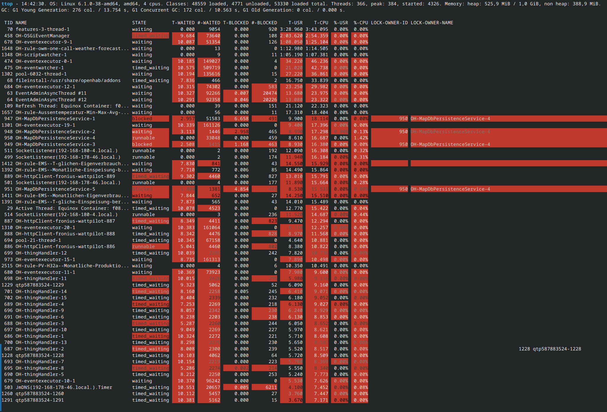

# Thread Monitor
When experiencing high CPU usage by openHAB, one of its threads might be running wild.
Similarly to the familiar htop command on Linux, Karaf provides the ttop command to analyse CPU usage per thread.
The following example of the ttop command displays thread ID, name, state and various stats about each thread, all ordered by the CPU time:
ttop --stats=tid,name,state,waited_time,waited_count,blocked_time,blocked_count,user_time,cpu_time,user_time_perc,cpu_time_perc,lock_owner_id,lock_owner_name --order=cpu_time --millis=300
To get more information about a thread, you may use the following command, where XXXX is the thread ID:
threads XXXX
# Example
As you can see, there are a few rule and MapDB threads consuming a good amount, as well as openHAB's OSGiEventManager.
To get more details about the OH-OSGiEventManager thread, use the threads command: threads 458
The following information is printed to the console:
Thread 458 OH-OSGiEventManager TIMED_WAITING
Stacktrace:
jdk.internal.misc.Unsafe.park line: -2
java.util.concurrent.locks.LockSupport.parkNanos line: 269
java.util.concurrent.locks.AbstractQueuedSynchronizer$ConditionObject.awaitNanos line: 1763
java.util.concurrent.LinkedBlockingQueue.poll line: 460
org.openhab.core.internal.events.ThreadedEventHandler.lambda$0 line: 59
org.openhab.core.internal.events.ThreadedEventHandler$$Lambda/0x0000000100b44258.run line: -1
java.lang.Thread.runWith line: 1596
java.lang.Thread.run line: 1583
