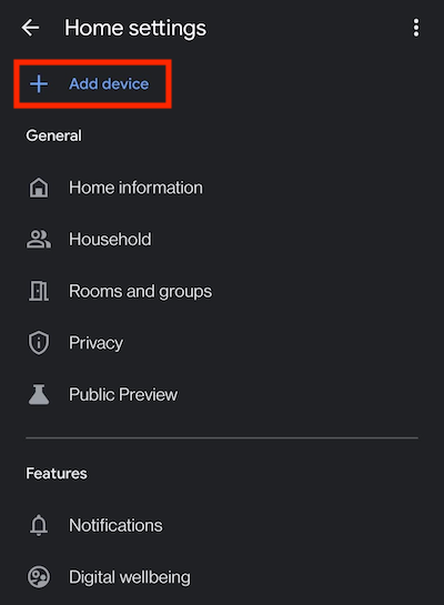

- Go to the settings part:
Home > Settings.
- Press the
+ Add devicebutton in the Settings screen.

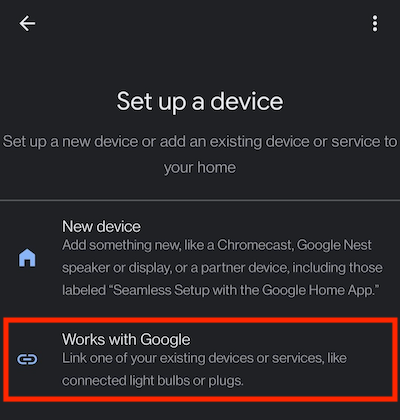

- Choose
Works with Google

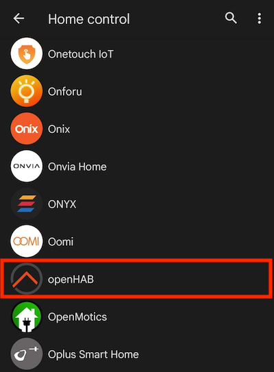

- Search and select
openHAB.

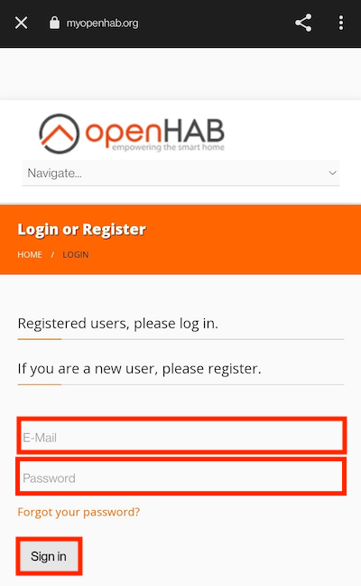

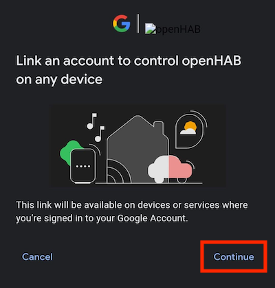

- Continue with linking your account.
- Login at
myopenhab.orgwith your username and password.
