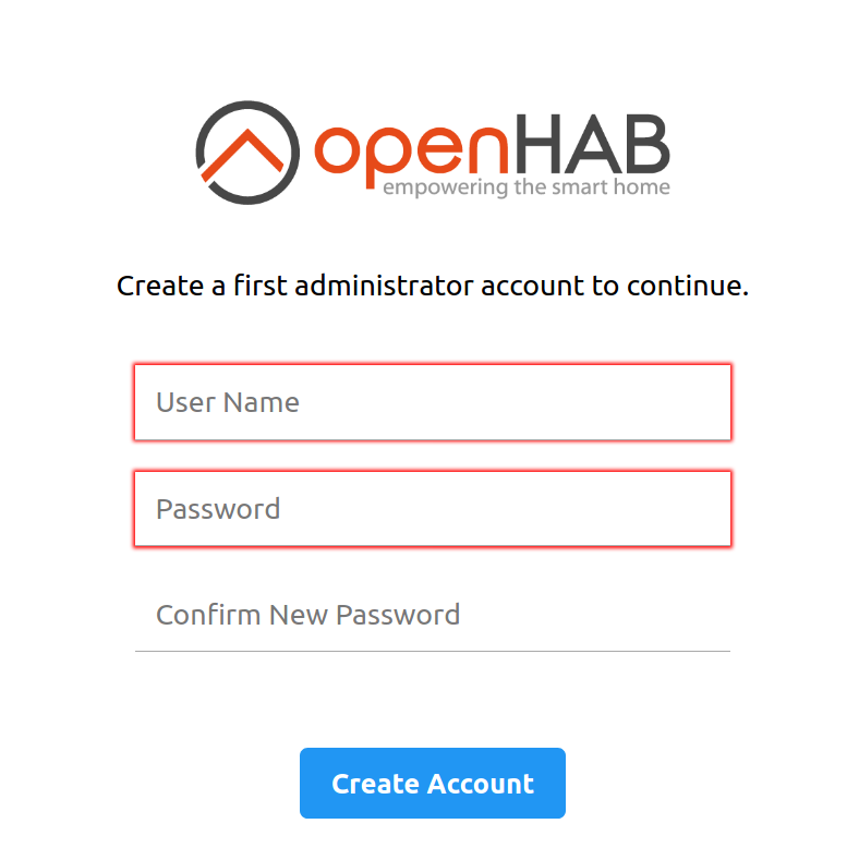

The first start may take up to 15 minutes, this is a good time to reward yourself with hot coffee or a freshly brewed tea!
You should be able to reach the openHAB Dashboard at http://openhab-device:8080 at this point. Be sure to check whether you need to adjust your firewall settings. If you're new to openHAB, then you should checkout the beginner's tutorial!
The openHAB Dashboard page

Everything is ready for a first test run. Execute openHAB and you should be able to reach the openHAB Dashboard at http://openhab-device:8080 after a few minutes:
# execute as restricted user openhab:
sudo su -s /bin/bash -c '/opt/openhab/start.sh' openhab
You will see the openHAB Console in your terminal and can directly interact with it. Please be aware, that openHAB will need a few minutes so finish the first start, even after the openHAB console is visible. Let openHAB settle for around 15 minutes. If the portal is not reachable by then, restart once.
The openHAB portal page
An important downside of the above method is, that openHAB will be terminated, as soon as you close your terminal. To work around that, a quick solution is, to execute openHAB in a detached screen (opens new window) terminal.
