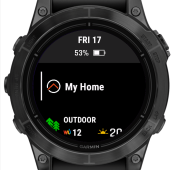

The app consists of two components: the Glance and the Widget. The Glance displays the name of the sitemap and acts as the entry point into the full-screen Widget, which shows the sitemap's content.
Once opened, the Widget polls the sitemap at a configurable interval to fetch updates. Commands are sent to openHAB via its JSON-based REST API. If your openHAB setup does not support this API, you can alternatively configure a custom Webhook.
Inside the Widget, sitemap elements are displayed as Sitemap Widgets.

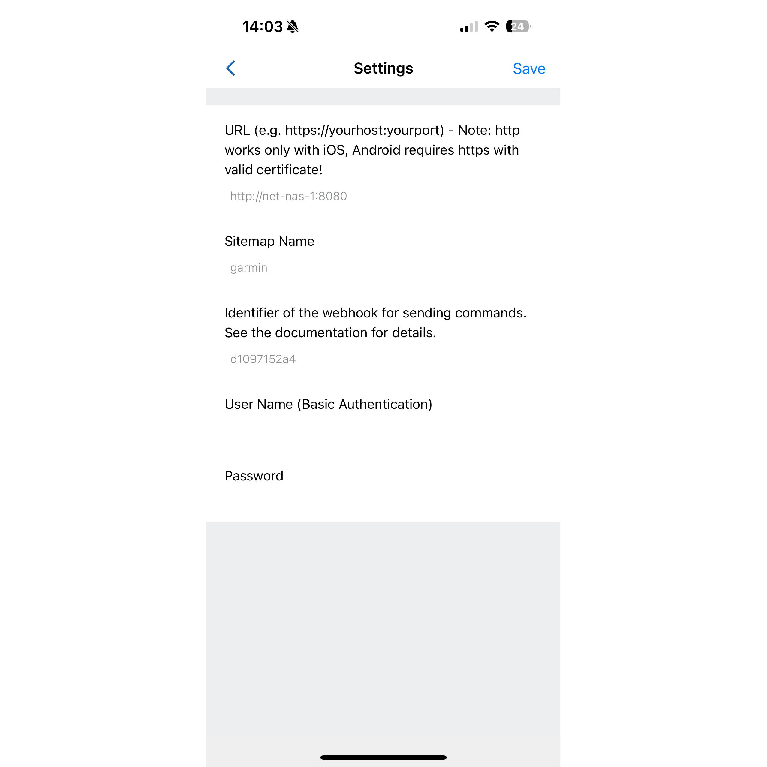

# Configuration

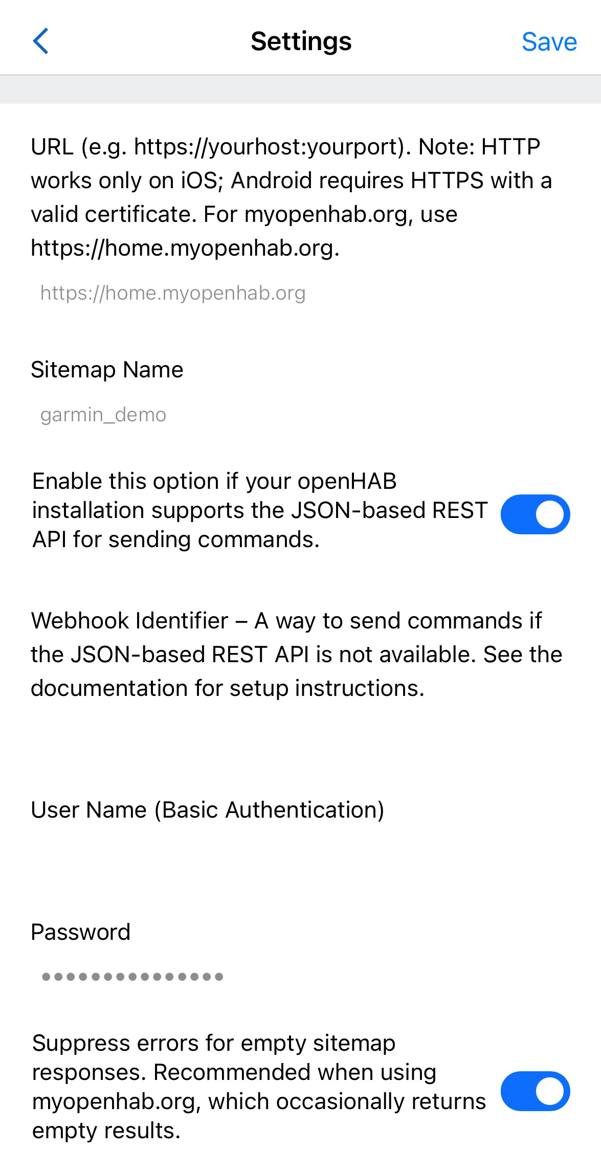

Once the app is installed, you can configure the following settings by opening it in the Garmin Connect IQ smartphone app.
Setting Description
URL Your openHAB URL in the format https://host:port or http://host:port. Note: HTTP only works with iOS. See Connectivity and Using myopenHAB for details.
Sitemap Name Name of the sitemap to display. See Sitemap Setup for details.
Native REST API Support Enabled by default. When enabled, the app uses the JSON-based REST API to send commands. See Sending Commands for details.
Webhook Identifier If your openHAB version does not support the JSON-based REST API (see above), you can disable the setting above and configure a custom webhook instead to send commands. See Sending Commands for details.
Username For basic authentication (used for myopenHAB, see below)
Password Password for basic authentication
Supress empty response errors Suppress errors for empty sitemap responses. Recommended when using myopenhab.org (opens new window), which occasionally returns empty results. See the related openhab-cloud issue #496 (opens new window) for details.
Polling Interval (ms) Interval between data requests to your openHAB instance. Set to 0 to fetch new data immediately after the previous response is processed. Polling only occurs while the app is open, not in the background. If you're using myopenhab.org (opens new window), it's recommended to use the default (3000 ms) or a higher value to avoid overloading their servers. If you're connecting to your own openHAB server directly, you may try setting it to 0 for more responsive updates.
Post command hold time (ms) Time during which state updates are ignored after a command is sent. Since a sitemap request is executed immediately after sending a command, a slow response from openHAB may still return the previous state, causing switches in the UI to briefly toggle back and forth. The post-command hold time prevents this by locking the item state for a configurable duration while the command is processed and the new state is applied.

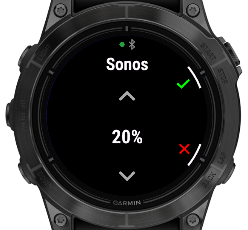

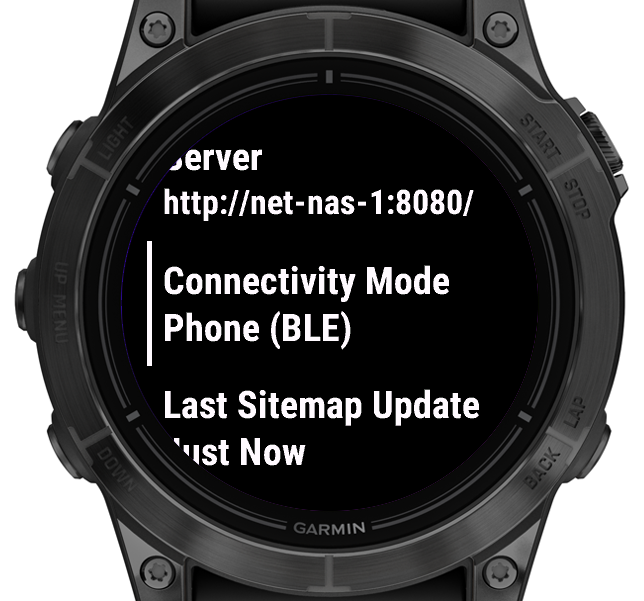

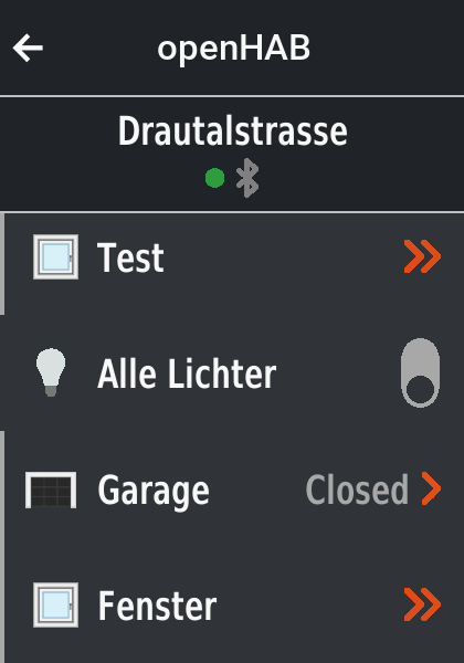

A green status indicator and a Bluetooth icon at the top of the menus and full-screen views indicate that a BLE connection is available. Also, the current connectivity mode can be checked in the settings menu.

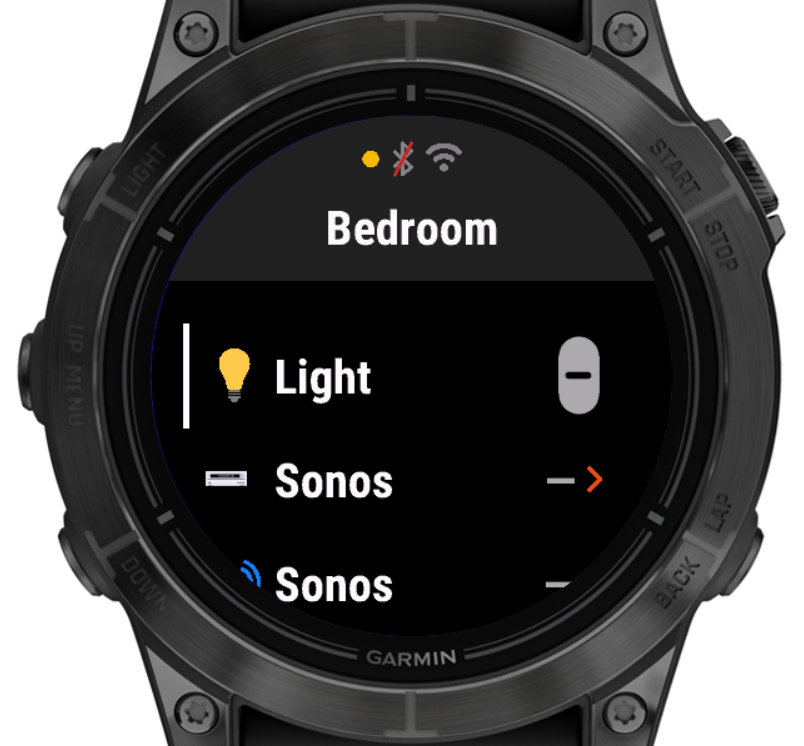

# Wi-Fi
Some Garmin wearables can also connect directly to Wi-Fi. This allows access to the local LAN and, if Internet connectivity is available, to services such as myopenHAB.
When connected via Wi-Fi, both HTTP and HTTPS are supported.
Garmin does not allow a permanent Wi-Fi connection. Instead, the app must enter a dedicated sync mode, perform its network operations, and then close the Wi-Fi connection again. While this sync is active, Garmin displays system-provided views to inform the user about sync progress.

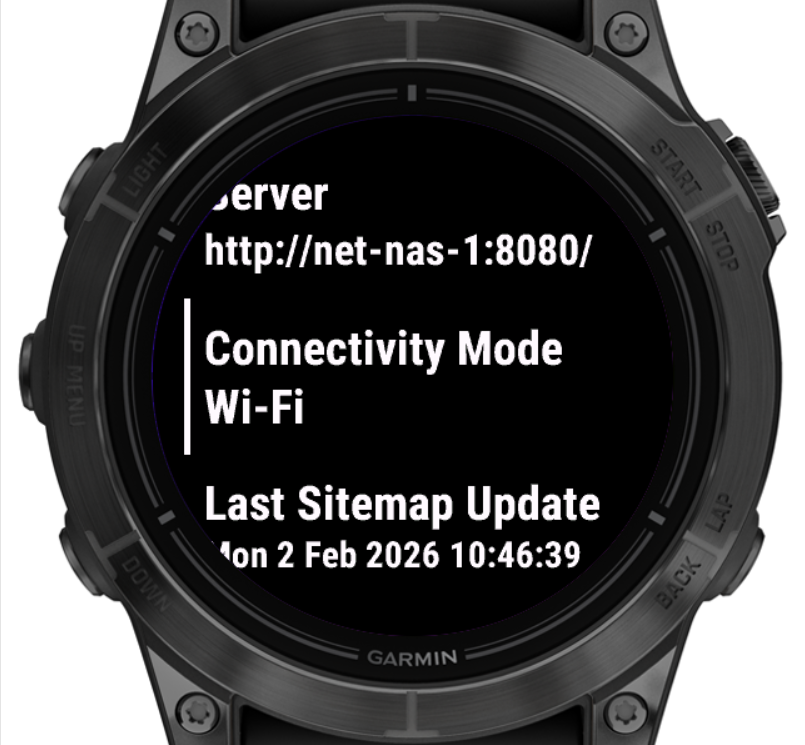

# Automatic Wi-Fi Detection and Mode Switching
If no BLE connection to a phone is available, the app automatically checks whether a Wi-Fi connection can be used and, if so, switches to Wi-Fi mode. These checks continue while the app is running, and the app may switch between BLE and Wi-Fi connectivity at any time.
At startup, if no BLE connection is available, a red status indicator indicates that the app is offline. A Wi-Fi icon with a magnifying glass shows that the app is searching for a Wi-Fi connection. Once connected to Wi-Fi, the status indicator turns yellow, indicating Wi-Fi mode.

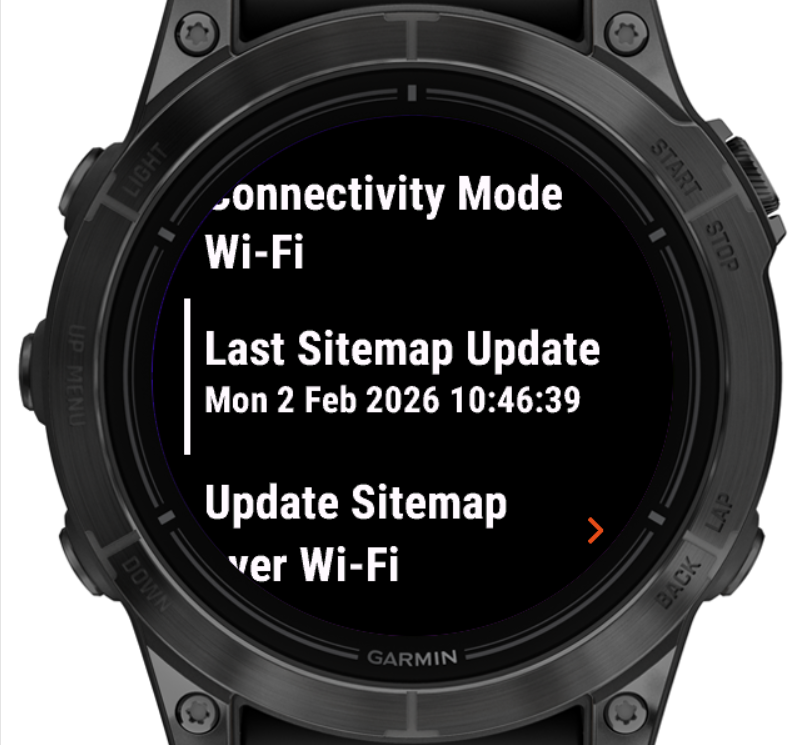

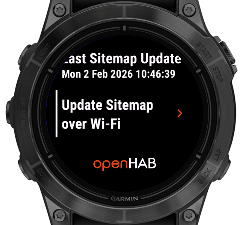

# No Polling of Sitemap Changes and States
Due to the limitations of the Wi-Fi mode, the app does not regularly poll openHAB for sitemap changes or state updates while in Wi-Fi mode. As a result, item states are not displayed.
Only if no cached sitemap is available at startup, for example after settings changes or a fatal error, the app enters sync mode to retrieve the full sitemap. The settings menu shows when the sitemap was last retrieved, and the user can also manually trigger an update via Wi-Fi, for example to download structural changes to the sitemap.
If you encounter a -402 error:
On devices with limited memory, the size limit for sitemaps can be lower in Wi-Fi mode than over a BLE connection. In such cases, retrieving the sitemap via Wi-Fi may result in a -402 communication error.
If this occurs, try updating the sitemap over BLE before reducing the sitemap size.

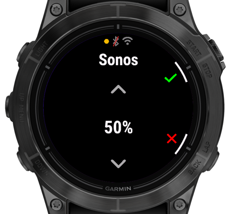

# Sending Commands
Because current item states are not available in Wi-Fi mode, sending commands cannot rely on existing state information. For toggle switches, this means the user must explicitly choose whether the item should be switched on or off via an action menu.
Another example is the Slider. In Wi-Fi mode, the slider always starts at the middle of its range and operates in releaseOnly mode. The command is sent only when the new value is confirmed, not while the value is being adjusted.

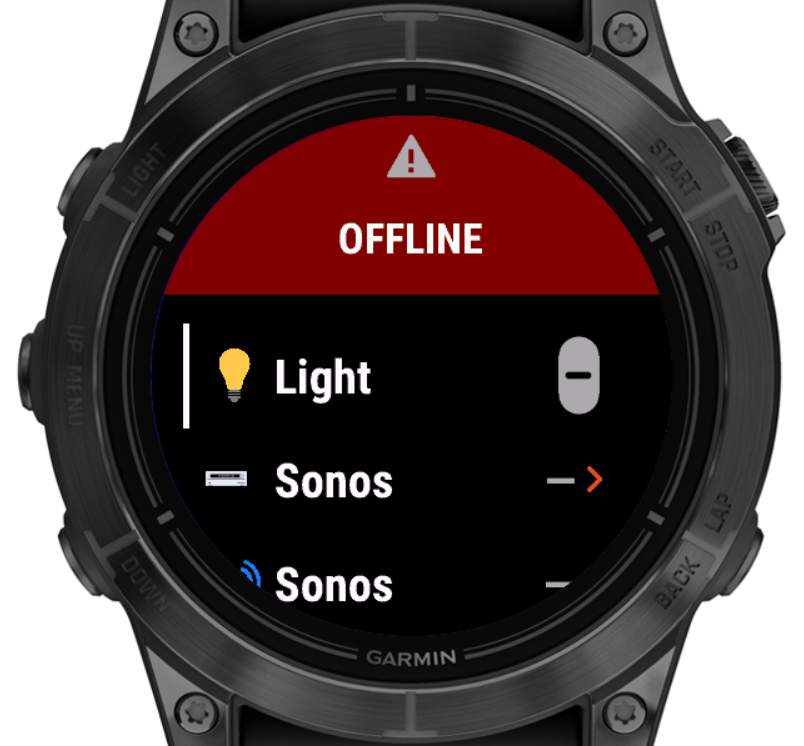

# Offline
While searching for Wi-Fi, and whenever neither BLE nor Wi-Fi is available, the app enters offline mode, indicated by a red status indicator. In offline mode, the menu structure can still be navigated. However, when attempting to send a command, an “OFFLINE” toast notification is displayed.

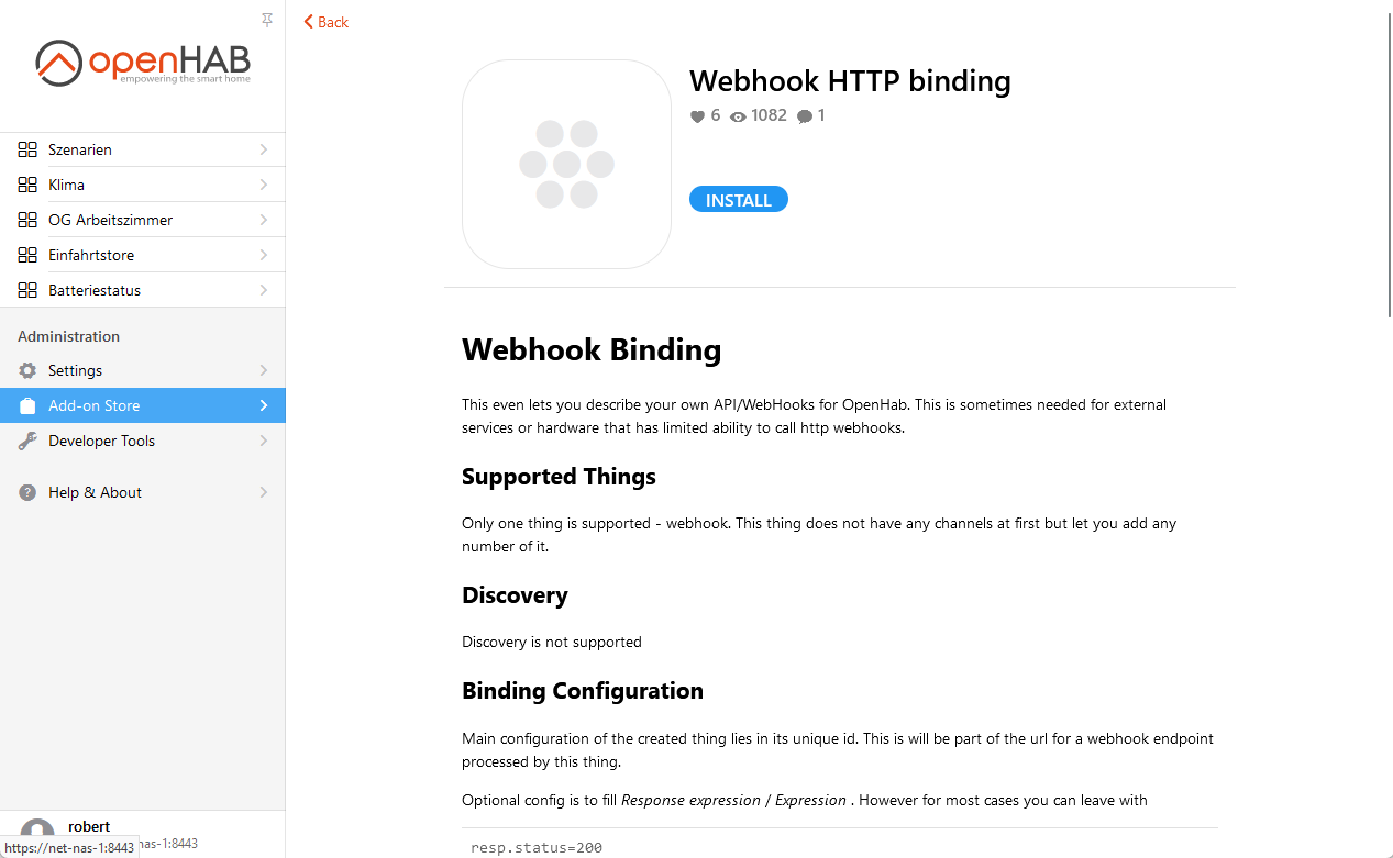

# 1. Install the Webhook Binding
Install the Webhook HTTP binding (opens new window).
Web Hook Installation

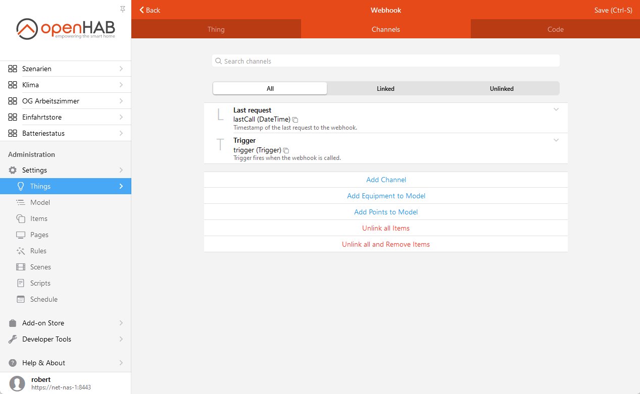

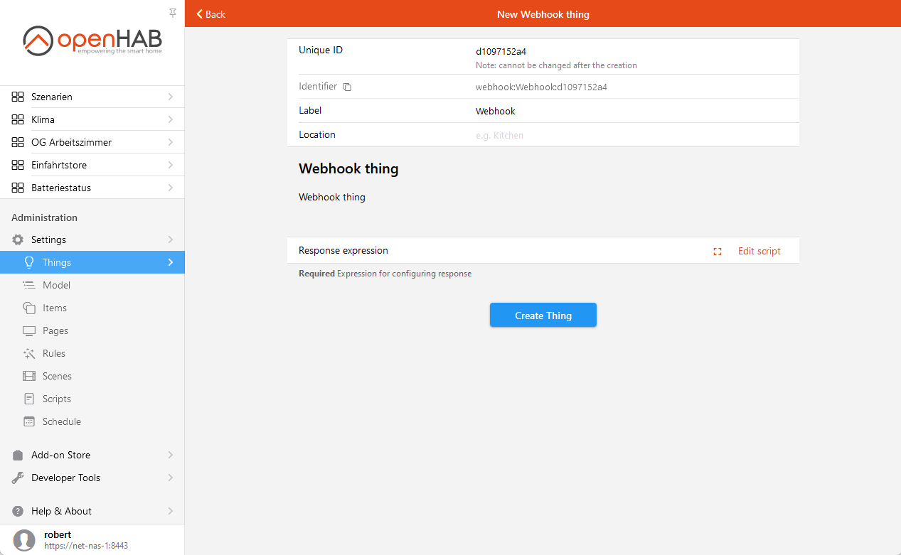

# 2. Create a Webhook Thing
Create a new Webhook Thing.
Thing Creation
Go to the Code tab and enter the following YAML (replace UID with your own):
UID: webhook:Webhook:d1097152a4
label: Webhook
thingTypeUID: webhook:Webhook
configuration:
  expression: resp.status=200
channels:
  - id: lastCall
    channelTypeUID: webhook:lastCall-channel
    label: Last request
    configuration: {}
  - id: trigger
    channelTypeUID: webhook:trigger-channel
    label: Trigger
    configuration:
      expression: >-
          var gson = new("com.google.gson.Gson");
          var jsonRoot = {:}; var jsonBody = {:};
          if (!empty(req.body.text)) jsonBody.put("text", req.body.text);
          if (!empty(req.body.json)) jsonBody.put("json", req.body.json);
          jsonRoot.put("parameters", req.parameters);
          jsonRoot.put("body", jsonBody);
          jsonRoot.put("method", req.method);
          return gson.toJson(jsonRoot);
Thing Channels

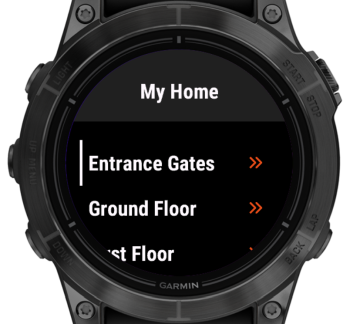

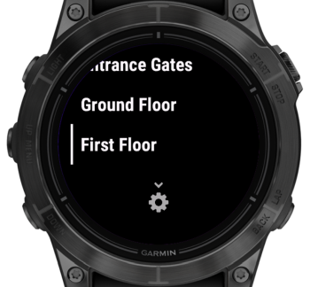

# Frame
The ➡️ Frame element is one of three sitemap elements that support hierarchical structuring.
You can nest Frame elements within other Frame elements. While this is allowed by the specification, openHAB may log a warning when doing so — but it still functions as expected.
Technically, the specification does not permit mixing Frame elements alongside other element types at the same hierarchy level. However, in practice, this does work in openHAB. If you choose to use this unsupported approach, be aware that you're doing so at your own risk.
Here is an example of a sitemap containing three Frame elements.
sitemap garmin_demo label="My Home" {
 Frame label="Entrance Gates" {
  Switch item=EntranceGatesTrigger label="Open/Close" mappings=[OFF="", ON="OK"]
  Text item=EntranceGateStatus label="Status"
 Frame label="Ground Floor" {
 Frame label="First Floor" {

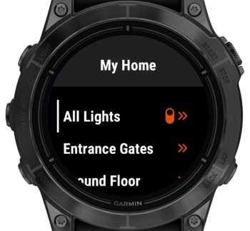

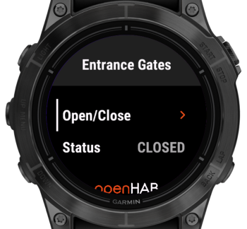

This configuration produces the following display in the UI:

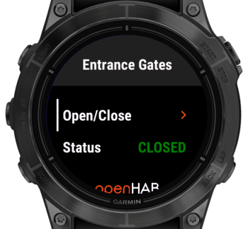

# Text
The ➡️ Text Sitemap Widget is used to display the current state of an item without allowing any user interaction.
# Supported parameters:
  • label: the label shown in the UI.
  • item: the name of the openHAB item whose state should be displayed.
This widget is ideal for showing read-only information, such as temperature, system status, or sensor readings. It also supports nested elements, making it suitable for creating a hierarchical sitemap structure.
# Example configuration:
In this example, the Text Sitemap Widget is used to display the status of entrance gates. Triggering the gates is handled by a separate Switch element.
  Switch item=EntranceGatesTrigger label="Open/Close" mappings=[OFF="GO", ON="DONE"]
# Resulting UI:

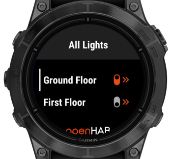

# Group
The ➡️ Group Sitemap Widget will present a submenu containing all the items in the associated item of type Group. This also works recursively, if the Group item itself contains other Group items, those will again open their own submenus.
In this example, the CC_House_Lights item represents a hierarchical structure: it contains groups for each floor (e.g., the first floor), which in turn contain groups for individual rooms, and those room groups include the actual light switch items.
 Group item=CC_House_Lights label="All Lights"
# Resulting UI:

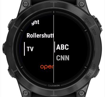

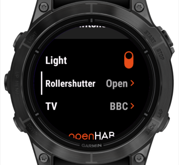

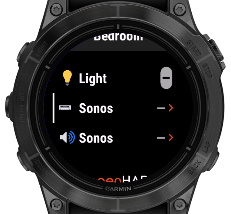

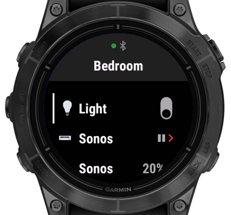

# Switch and Selection

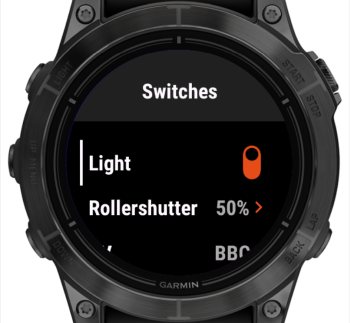

The ➡️ Switch and ➡️ Selection widgets display the current state of an item and allows the user to send commands to change it.
In other UIs, the Switch and Selection widgets behave differently:
  • Switch presents all available options inline within the page.
  • Selection opens a dedicated selection dialog to choose a value.
However, due to the limited screen space on wearables, the Garmin app always opens a dedicated action menu whenever there are more than one or two options.
As a result, Selection is treated as a synonym for Switch, and both behave identically in the Garmin app.
  • label: Text displayed in the UI.
  • item: Name of the associated openHAB item.
  • mappings (optional): Defines command-to-label mappings for display and interaction.
The widget supports four usage variants:

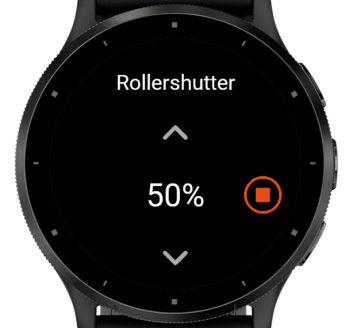

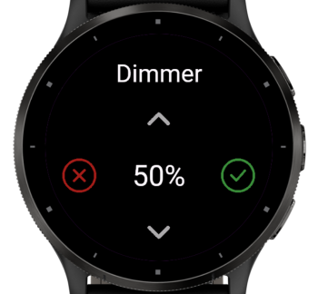

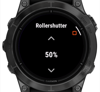

  1. Toggle Switch – for binary items (ON/OFF) and Dimmer items.

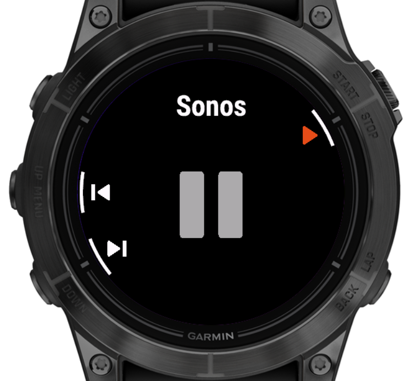

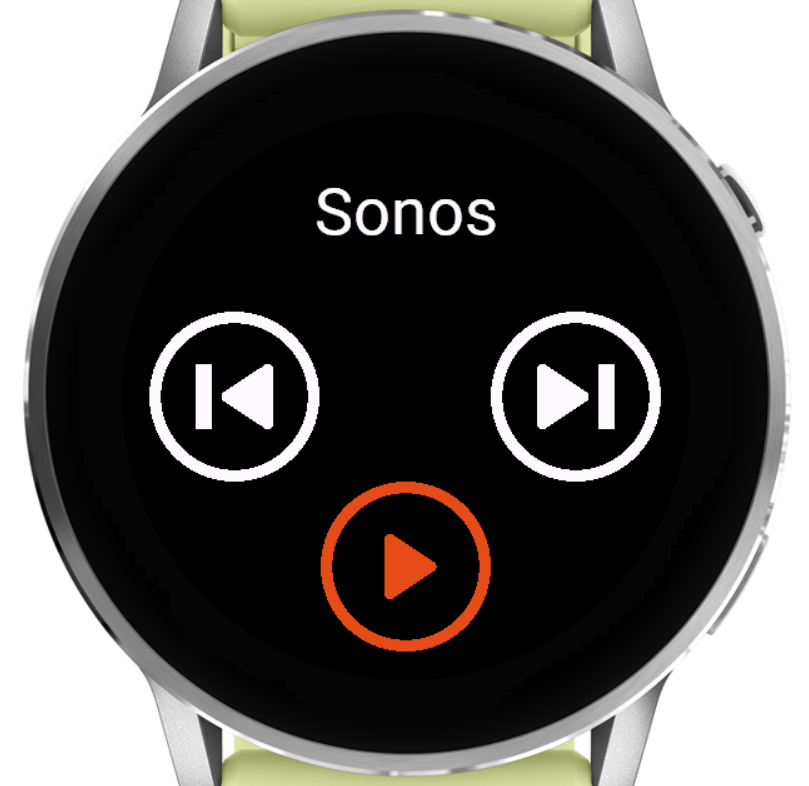

  2. Rollershutter Control – a full-screen view for Rollershutter items with UP, DOWN, and STOP buttons.
  3. Player Control – a full-screen view for Player items with PLAY/PAUSE, NEXT, and PREVIOUS buttons.
  4. Generic Switch – for items with custom or multiple commands, defined via mappings or item metadata.
# Toggle Switch

Frame label="Switches" {
    Switch item=Light label="Light"
UI Preview:

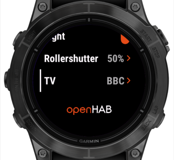

# Rollershutter
When the item type is Rollershutter, the widget opens a full-screen control with UP, DOWN, and STOP actions.
In the menu, the item displays a textual or percentage-based state:
  • mappings can be used to map numeric states (e.g., 0="Open", 100="Closed"), but only affect the menu label.
  • The full-screen view always shows numeric percentages for clarity, since states like 0 and 100 can reflect transitional movement (e.g., “opening”) rather than final state (“open”).
Example:
    Switch item=Rollershutter label="Rollershutter" mappings=[0="Open", 100="Closed"]
UI Preview:
# Player
When the item type is Player, the widget opens a full-screen control with PLAY/PAUSE, NEXT, and PREVIOUS actions. In the menu, the item displays the PLAY/PAUSE state.
Example:
    Switch item=MediaControl label="Audio"
UI Preview:
# Generic Switch
This variant is used for items that don’t fall under the previous two cases.
It supports multiple custom commands, defined either via:
  • mappings in the sitemap,
  • or command/state descriptions on the item (e.g., from a channel or metadata).
In the menu, the widget displays the current state as text:
  • If the state matches one of the mapped commands, the corresponding label is shown.
  • Otherwise, the raw state is displayed.
Tip: You can use an empty label in mappings if the item's function is self-explanatory from context.
Selection behavior:
  • If one command is defined, it is sent immediately when the item is selected.
  • If two commands are defined and one of them matches the current state, the other is sent immediately.
  • In all other cases, an action menu appears on the right side of the screen, allowing the user to select from the list of available commands. If the current state matches one of the commands, that command is not shown in the menu.
Example:
    Switch item=TV label="TV" mappings=[0="ABC", 1="BBC", 2="CNN"]
UI Rendering:
Note: The action menu shown in the right screenshot is a mockup. The actual appearance may vary depending on the device, as it uses a native UI component.
Example with Empty Mapping Entry:
Consider a garage door opener that acts as a toggle switch: sending an ON command triggers the gate to open or close, and the switch automatically resets to OFF after one second.
This can be configured in the sitemap like so:
  Switch item=EntranceGates_Operation label="Open/Close" mappings=[OFF="", ON="OK"]
  Text item=EntranceGates_Status label="Status"
In this configuration:
  • The switch typically stays in the OFF state, where the "Open/Close" label is sufficient.
  • When pressed, it sends the ON command, briefly displays "OK" as feedback, then returns to OFF.
Here’s how the interface appears when the switch is in the OFF state:

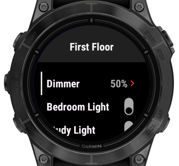

# Setpoint and Slider
The ➡️ Setpoint and ➡️ Slider widgets are numeric controls used to display and adjust the numeric state of an item.
When selected, both widgets open a full-screen view for choosing a new value, which is then sent as a command to the item.
The only behavioral difference between the two is the Slider widget’s support for the releaseOnly parameter (see below).
# Supported Parameters
  • label: the label displayed in the UI.
  • item: the name of the associated openHAB item.
  • minValue: lower bound of the selectable range (default: 0).
  • maxValue: upper bound of the selectable range (default: 100).
  • step: interval between selectable values (default: 1).
  • releaseOnly: (Slider only)
    • With releaseOnly: The value is only sent when the dialog is confirmed. Cancelling leaves the value unchanged.
    • Without releaseOnly: Values are sent immediately as the slider is moved. Confirming keeps the current value; cancelling reverts to the value before the dialog was opened.
# Notes and Limitations
  • Floating point values are supported with a maximum of four decimal places, for example 1.2345.
  • A maximum of 100 steps is supported, for example:
    • minValue=0, maxValue=100, step=1
    • minValue=0, maxValue=50, step=0.5
  • While up to 100 steps are supported, this can be impractical for wearable interfaces. It is recommended to define the range and step so that the total number of steps is limited to roughly 10 to 20, making interaction significantly more manageable.
  • The formatting pattern defined in the item’s metadata is not used. Instead, predefined formatting rules are applied when displaying values:
    • In the menu, values are formatted as compactly as possible and the unit is appended without a space to conserve space. For example “20°C” or “20.5°C”.
    • In the full-screen widget, values are always formatted with the same number of decimal places as defined by the step. The unit is appended with a space, except for %. For example “20.0 °C” or “20.5 °C” with step=0.5.
  Slider item=Dimmer label="Dimmer" minValue=0 maxValue=100 step=10
Resulting UI:
  • The lower-left screenshot shows the slider on a button-based device.
  • The lower-right screenshot shows the slider on a touch-based device.
Note: Even button-based devices may support touch input, and on those, the UI reacts to both. /On button-based devices, use up/down to scroll through the values, press enter (upper-right button) to confirm or back (lower-right button) to cancel. On touch-based devices simply tap the icons corresponding to the desired action or value to make a selection.

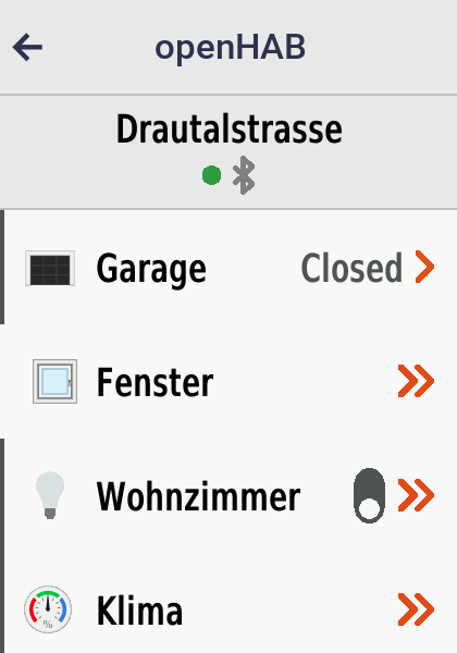

# Icons
For detailed usage and examples, refer to the sitemap icons documentation.
The Garmin app supports both the icon and staticIcon parameters, using a subset of the classic icon set. Where applicable, the app automatically selects an icon variant based on the item's state—for example, showing different icons for a light that is ON or OFF.
Below is a screenshot illustrating this behavior: The second menu item shows a filled lightbulb icon (indicating the light is ON), and the third item shows a state-aware rollershutter icon.
Tip: Even if you don't explicitly define icons in your sitemap, some may be applied automatically based on item metadata. To suppress this behavior, you can set the icon to an empty string in the sitemap: icon="".
Currently supported icons are:
  • batterylevel
  • blinds
  • door
  • frontdoor
  • garagedoor
  • heating
  • humidity
  • light
  • lightbulb
  • lowbattery
  • mediacontrol
  • player
  • poweroutlet
  • radiator
  • rollershutter
  • screen
  • slider
  • soundvolume
  • temperature
  • window
More icons can be added upon request. If you need support for additional icons, please post a request in the openHAB Community (opens new window).

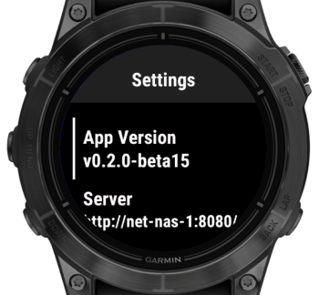

# Settings Menu
To access the settings menu:
  • On button-based devices, scroll down on the home screen and continue past the ⚙️ icon.
  • On touch-based devices, tap the ⚙️ Settings entry in the home screen menu.
The settings menu currently displays the app version and server URL. Additional features may be added in the future when the app evolves.
