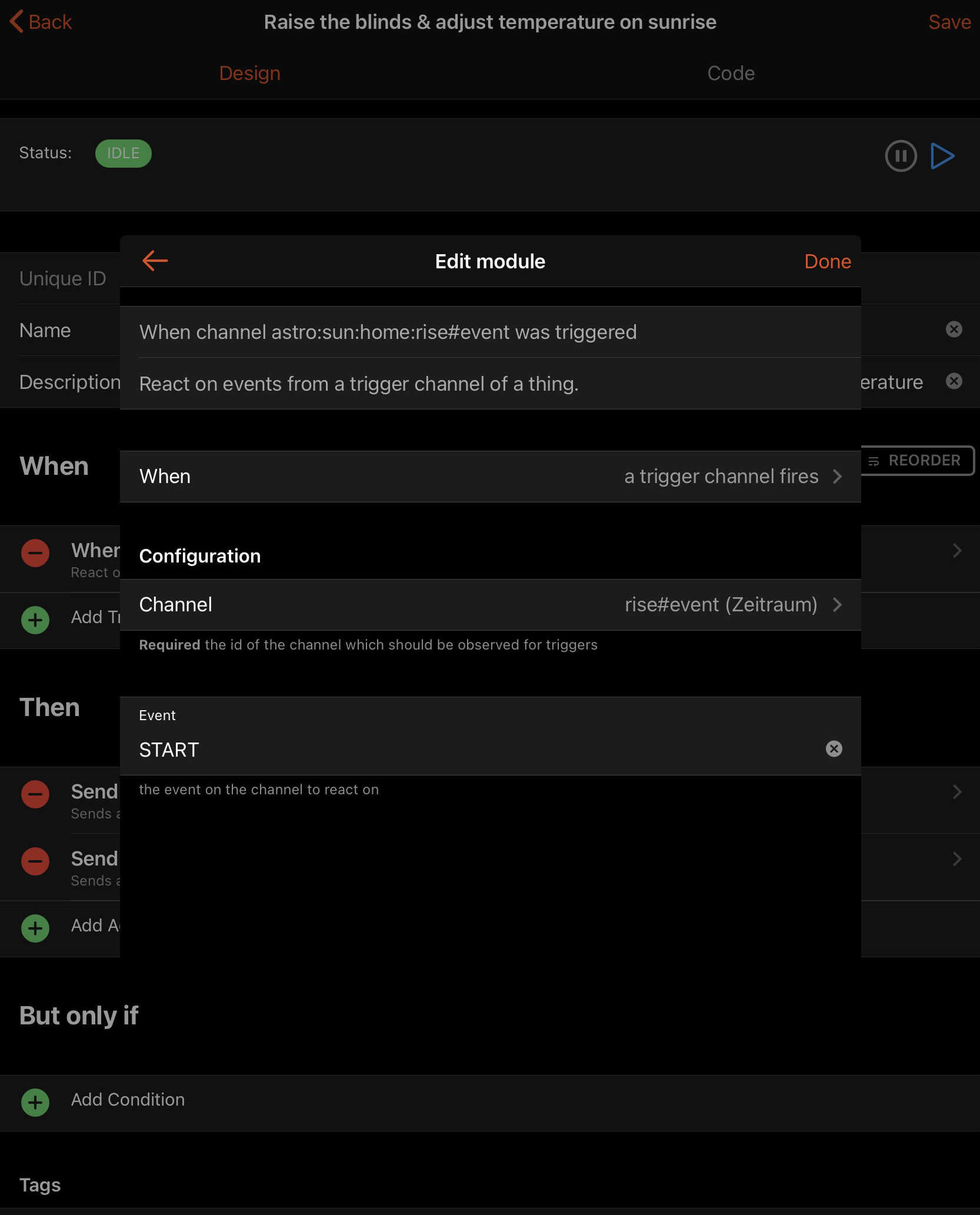

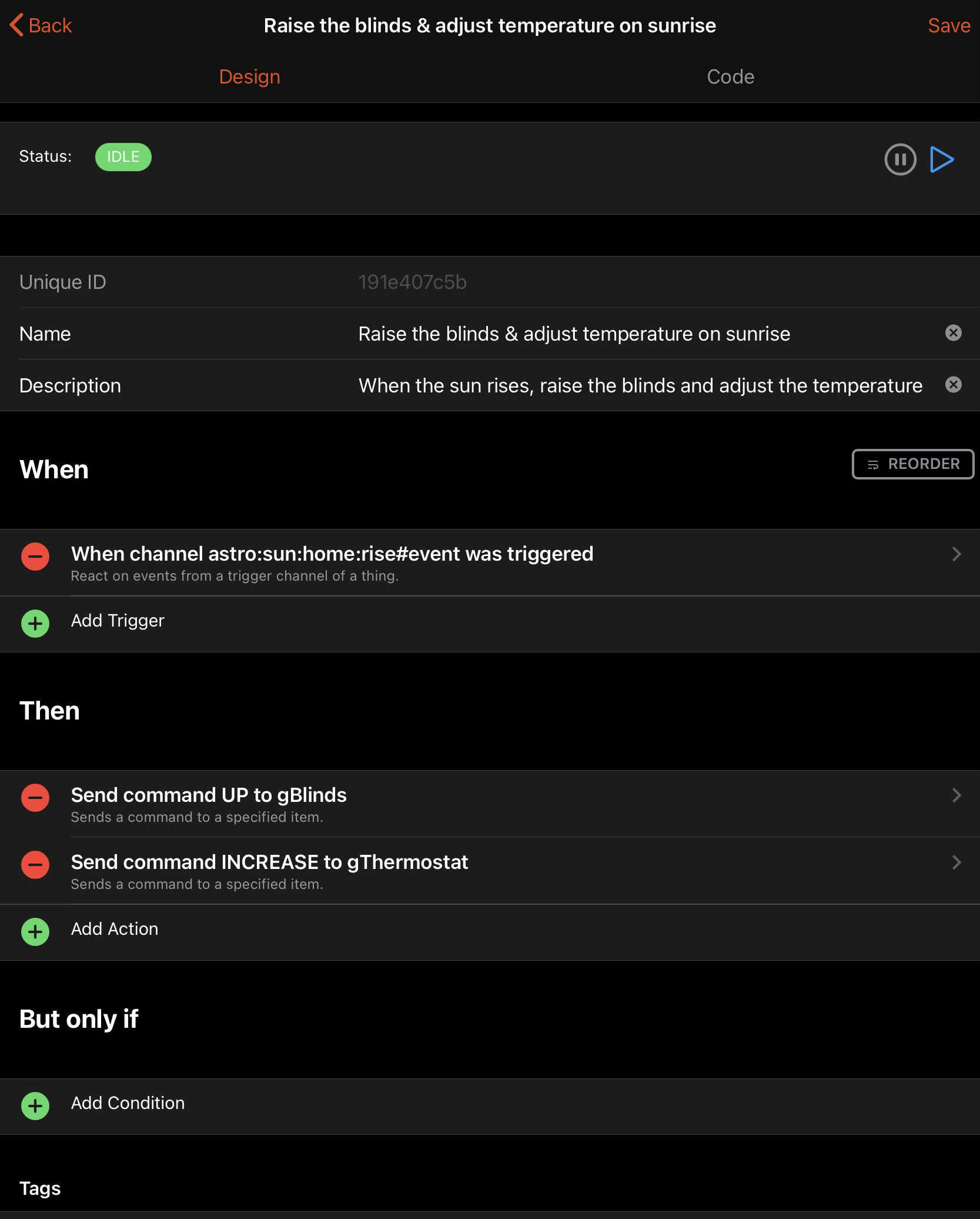

# When the sun rises, raise the blinds and adjust the temperature
This example is using the Astro Binding which calculates many values for sun and moon, including sunrise.

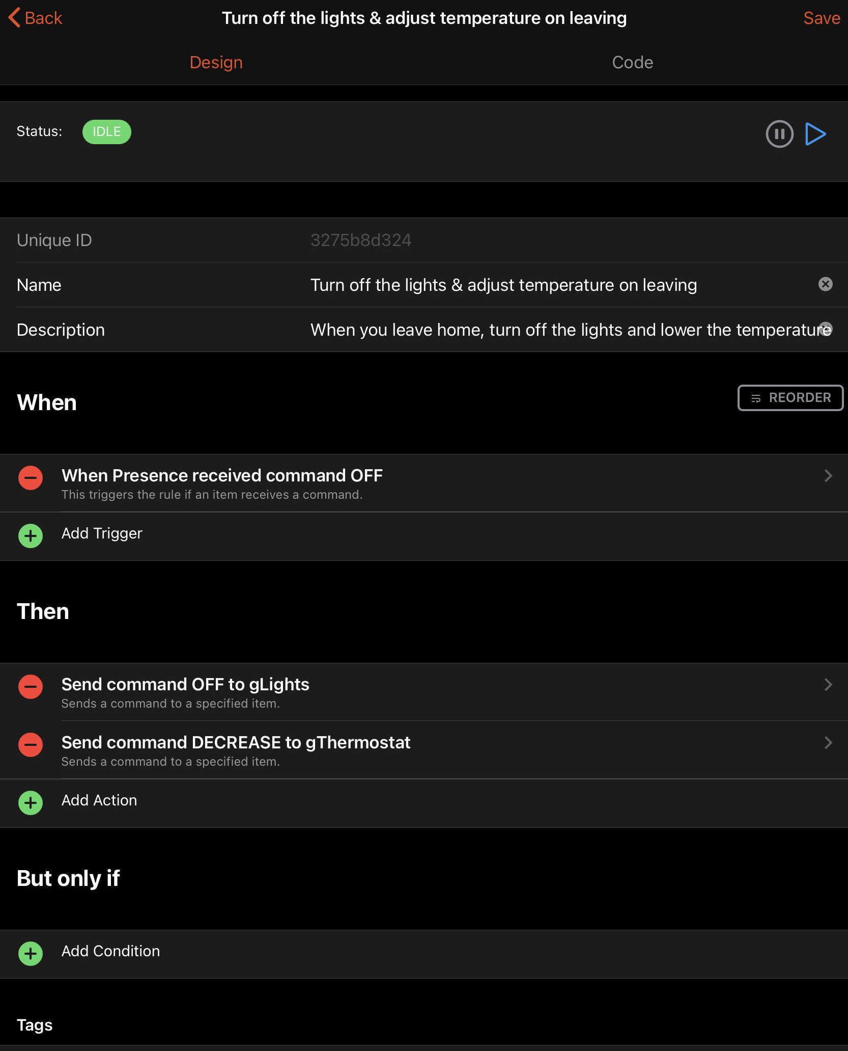

    # When you leave home, turn off the lights and lower the temperature
    Presence detection can be achieved in many ways, this example is not able to cover a mechanism used for presence detection. Most presence detection mechanisms control a switch Item with ON for present and OFF for away.
    Examples for presence detection include the iCloud Binding, Network Binding, GPSTracker Binding, etc., but you could also use a simple wall switch.

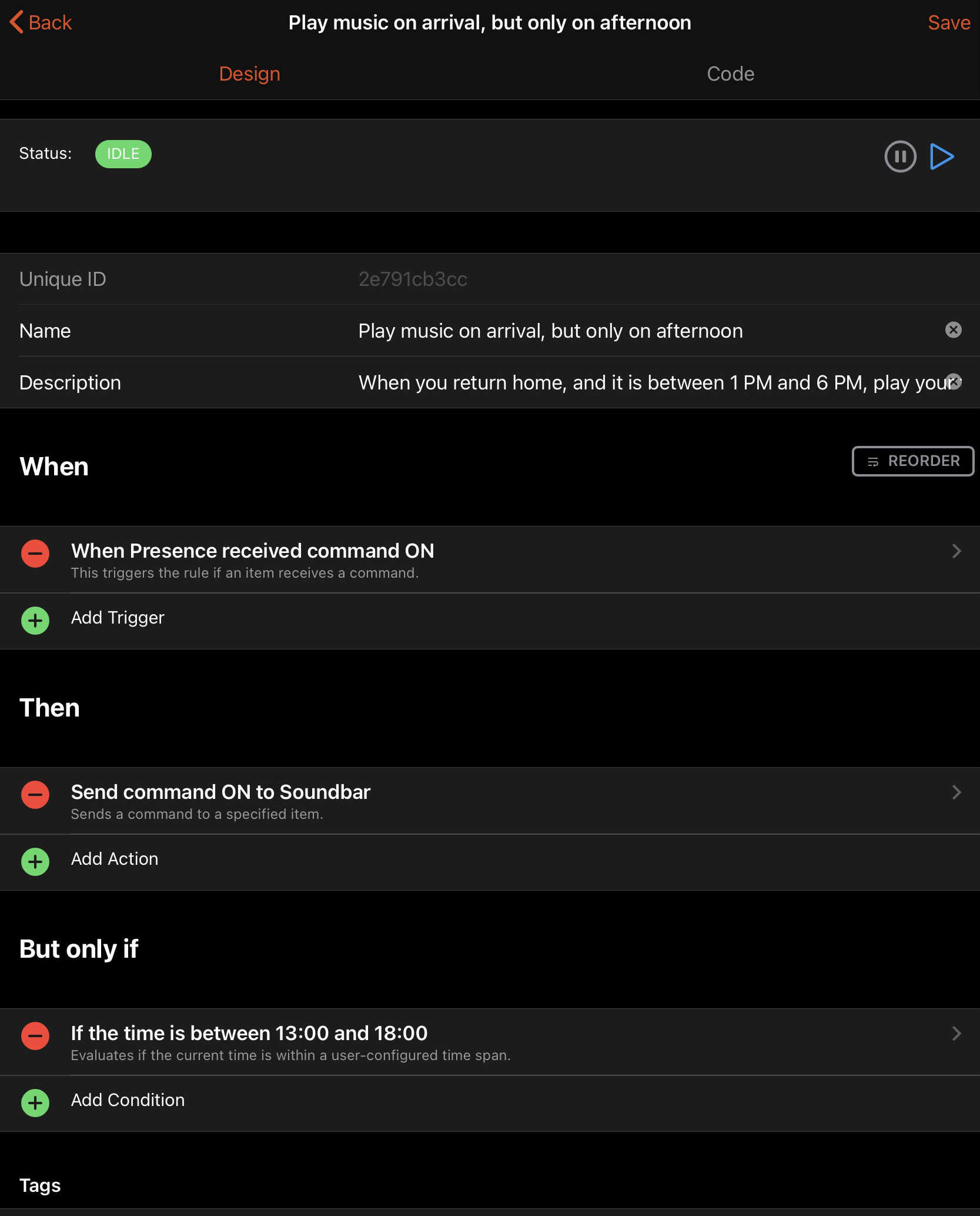

      # When you return home, and it is between 1 PM and 6 PM, play your favorite music

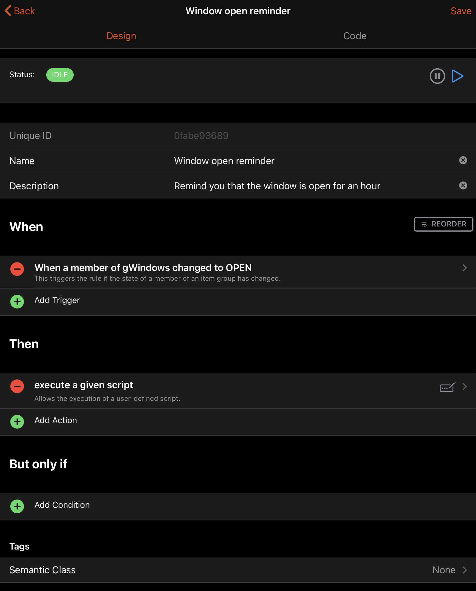

        # Remind you that the window is open for an hour

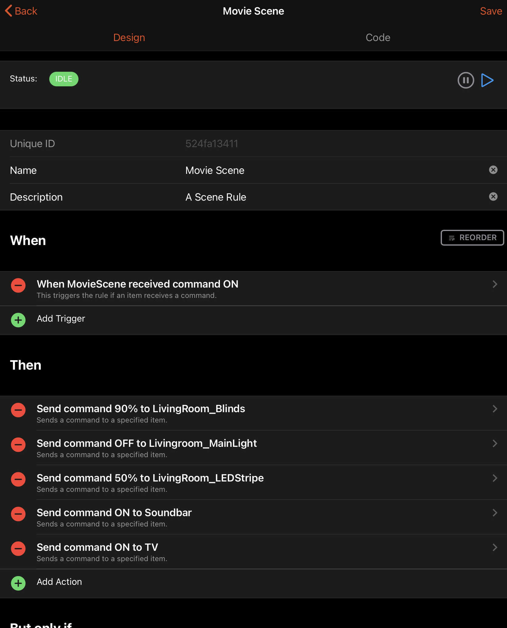

          # A "Scene" rule
          This rule example allows you to set multiple Items to a defined state using a single action.
          You might know this concept of "Scenes" from Apple HomeKit, Google Home, Philips Hue, etc.
