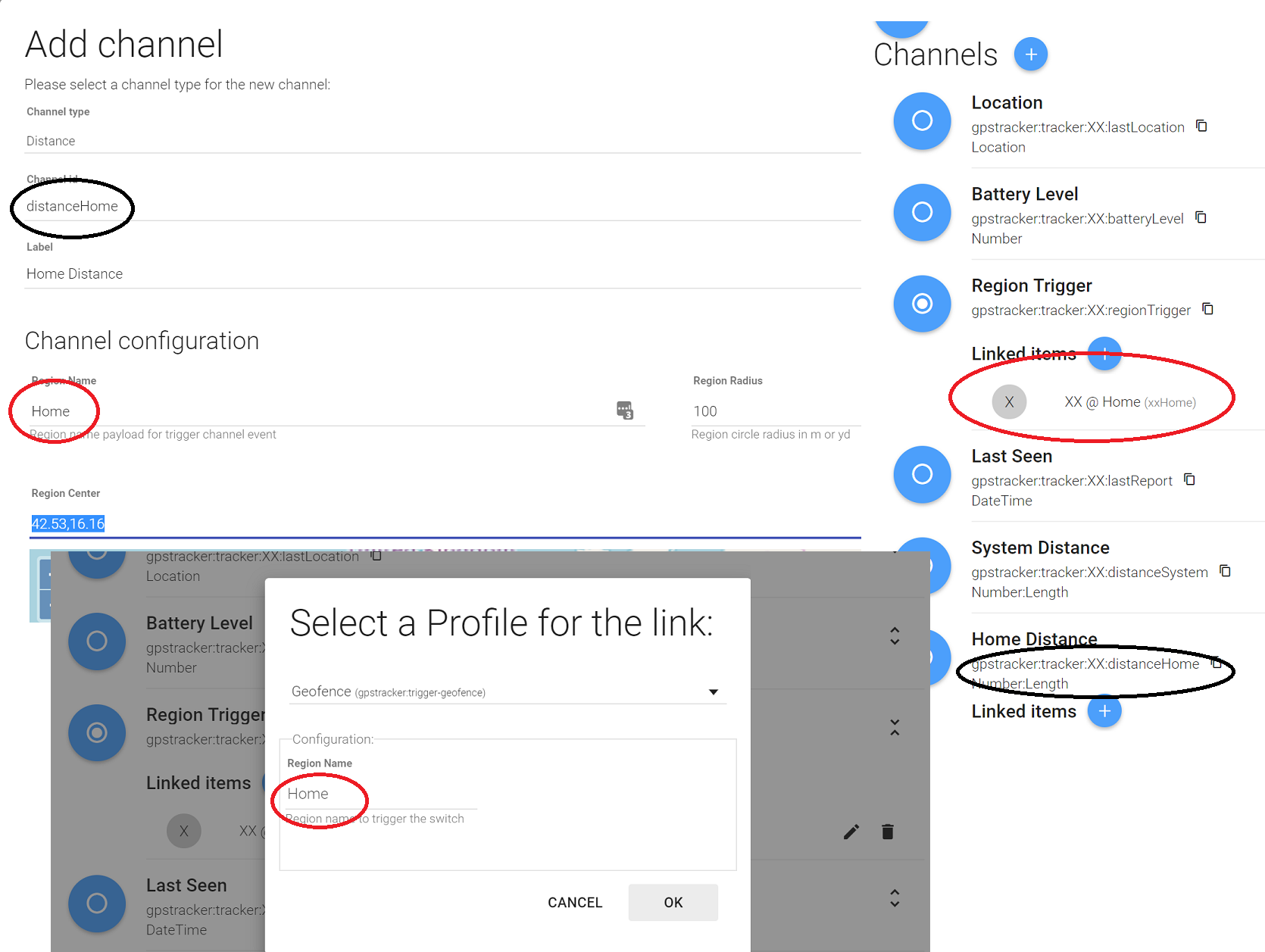

# Distance Channel and Presence Switch
Assumptions:
  • A Home distance channel is added to the tracker with parameters:
    • Channel ID: distanceHome
    • Region Name: Home
    • Region Radius: 100
    • Region Center: 42.53,16.16
  • Presence switch is linked to the regionTrigger channel with parameters:
    • Profile: Geofence(gpstracker:trigger-geofence)
    • Region Name: Home
After a location message received from the tracker the log should contain these lines:
2018-10-05 09:27:58.768 [DEBUG] [nal.provider.AbstractCallbackServlet] - Post message received from OwnTracks tracker: {"_type":"location","tid":"XX","acc":10.0,"lat":42.53,"lon":17.16,"tst":1527966973,"wtst":1524244195,"batt":96}
2018-10-05 09:27:58.769 [DEBUG] [cker.internal.handler.TrackerHandler] - Update base channels for tracker XX from message: org.openhab.binding.gpstracker.internal.message.LocationMessage@67e5d438
2018-10-05 09:27:58.770 [TRACE] [cker.internal.handler.TrackerHandler] - batteryLevel -> 96
2018-10-05 09:27:58.771 [TRACE] [cker.internal.handler.TrackerHandler] - lastLocation -> 42.53,17.16
2018-10-05 09:27:58.772 [TRACE] [cker.internal.handler.TrackerHandler] - lastReport -> 2018-06-02T19:16:13.000+0000
2018-10-05 09:27:58.773 [DEBUG] [cker.internal.handler.TrackerHandler] - Updating distance channels tracker XX
2018-10-05 09:27:58.774 [TRACE] [cker.internal.handler.TrackerHandler] - Region Home center distance from tracker location 42.53,17.16 is 82033.47272145993m
2018-10-05 09:27:58.775 [TRACE] [cker.internal.handler.TrackerHandler] - System uses SI measurement units. No conversion is needed.
2018-10-05 09:27:58.779 [DEBUG] [ofile.GPSTrackerTriggerSwitchProfile] - Trigger switch profile created for region Home
2018-10-05 09:27:58.779 [DEBUG] [ofile.GPSTrackerTriggerSwitchProfile] - Transition trigger Home/leave handled for region Home by profile: OFF
2018-10-05 09:27:58.792 [TRACE] [cker.internal.handler.TrackerHandler] - Triggering Home for XX/Home/leave
2018-10-05 09:27:58.793 [TRACE] [cker.internal.handler.TrackerHandler] - Region System center distance from tracker location 42.53,17.16 is 579224.192171576m
2018-10-05 09:27:58.794 [TRACE] [cker.internal.handler.TrackerHandler] - System uses SI measurement units. No conversion is needed.
