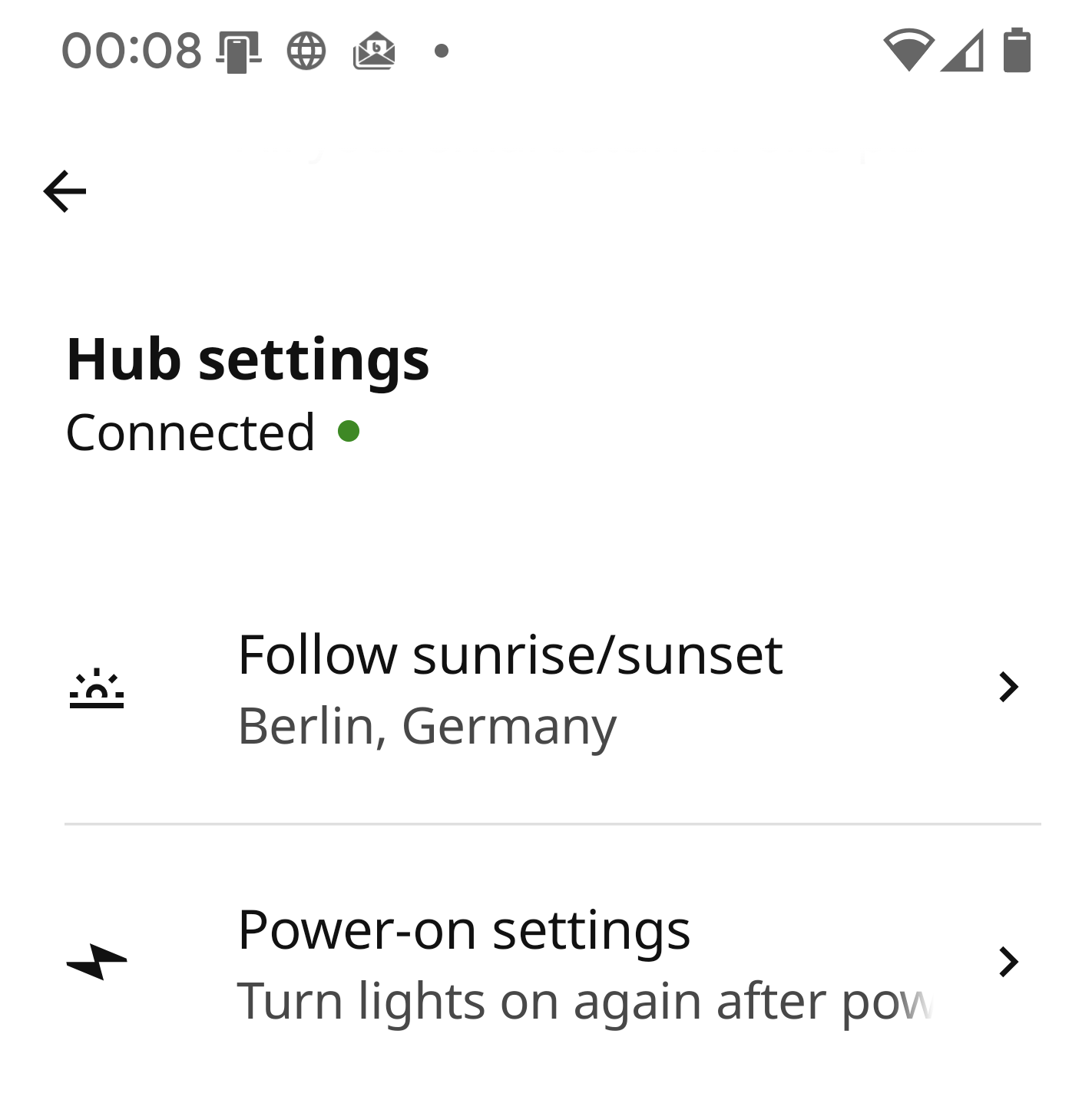

# Gateway Channels
| Channel | Type | Read/Write | Description |
pairing | Switch | RW | Sets DIRIGERA hub into pairing mode |
location | Location | R(W) | Location in lat.,lon. coordinates |
sunrise | DateTime | R | Date and time of next sunrise |
sunset | DateTime | R | Date and time of next sunset |
statistics | String | R | Several statistics about gateway activities |
Channel location can overwrite GPS position with openHAB location, but it's not possible to delete GPS data.
See Gateway Limitations for further information.

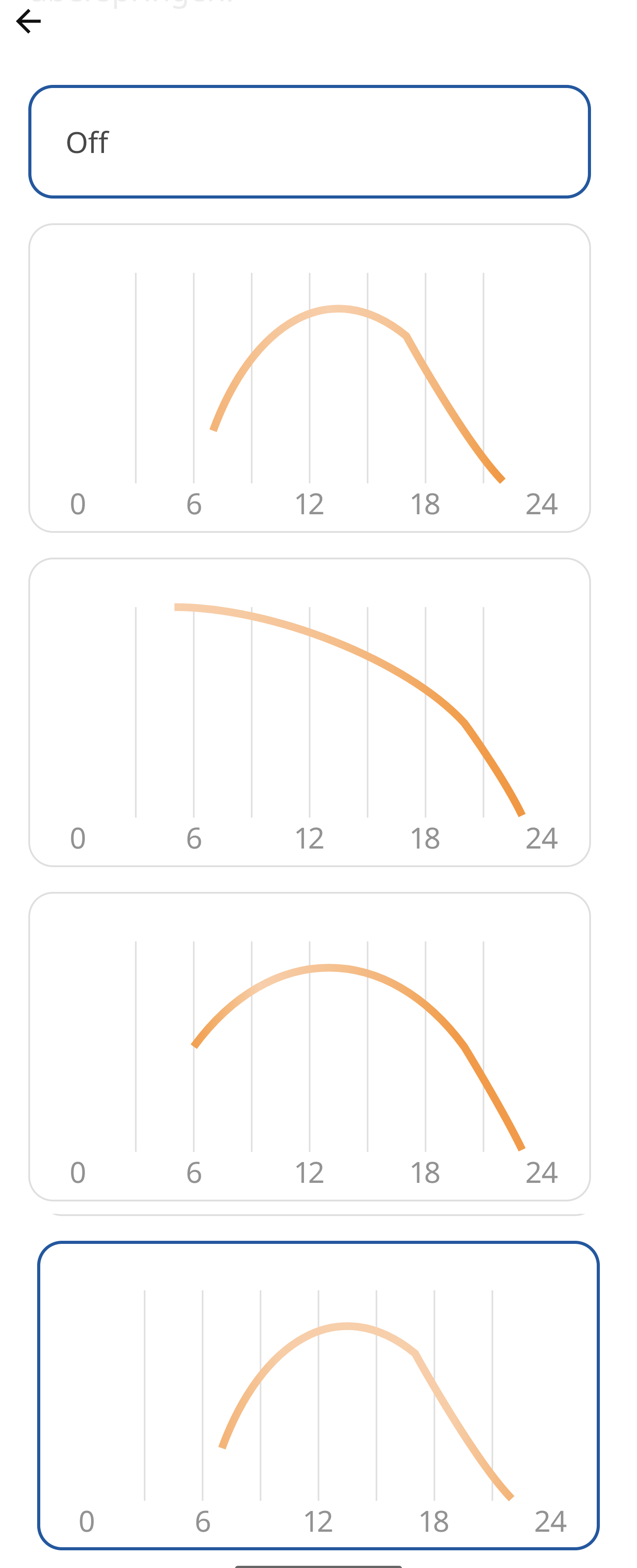

# Follow Sun
Motion Sensors can be active all the time or follow a schedule. One schedule is follow the sun which needs to be activated in the IKEA Home smart app in Hub Settings.

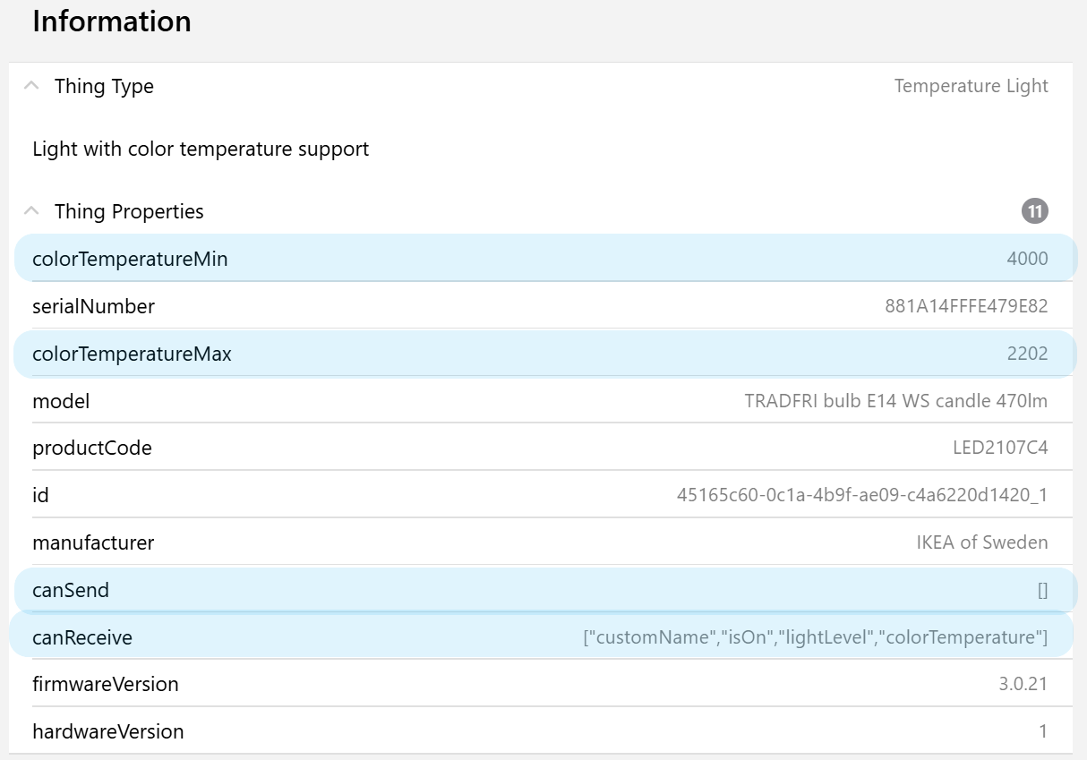

# Generic Thing Properties
Each thing has properties attached for product information.
It contains information of hardware and firmware version, device model and manufacturer.
Device capabilities are listed in canReceive and canSend.

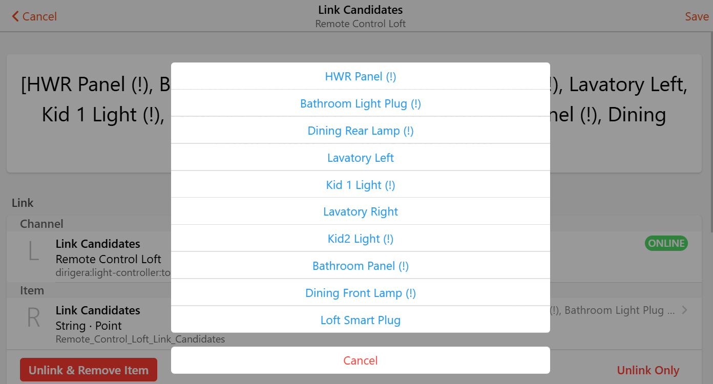

# Links and Candidates
Devices can be connected directly e.g. sensors or controllers with lights, plugs, blinds or speakers. It's detected during runtime if a device is capable to support links and if devices are available in your system to support this connection. The channels are declared advanced and can be used for setup procedure.
| Channel | Type | Read/Write | Description | Advanced |
links | String | RW | Linked controllers and sensors | X |
link-candidates | String | RW | Candidates which can be linked | X |
Several devices can be linked together like
- Light Controller and Motion Sensors to Plugs and Lights
- Blind Controller to Blinds
- Sound Controller to Speakers
Established links are shown in channel links.
The linked devices can be clicked in the UI and the link will be removed.
Possible candidates to be linked are shown in channel link-candidates.
If a candidate is clicked in the UI the link will be established.
Candidates and links marked with (!) are not present in openHAB environment so no handler is created yet.
In this case it's possible not all links are shown in the UI, but the present ones shall work.

Mappings for schedule
- 0 : Always, sensor is always active
- 1 : Follow sun, sensor gets active at sunset and deactivates at sunrise
- 2 : Schedule, custom schedule with manual start and end time
If option 1, follow sun is selected ensure you gave the permission in the IKEA Home smart app to use your GPS position to calculate times for sunrise and sunset.

light-preset | String | RW | Light presets for different times of the day |
Channel light-preset provides a JSON array with time an light settings for different times.
If light is switched on by the controller the light attributes for the configured time section is used.
This only works for connected devices shown in channel links.
IKEA provided some presets which can be selected but it's also possible to generate a custom schedule. They are provided as options as strings
- Warm
- Slowdown
- Smooth
- Bright
This feature is from IKEA test center and not officially present in the IKEA Home smart app now.
