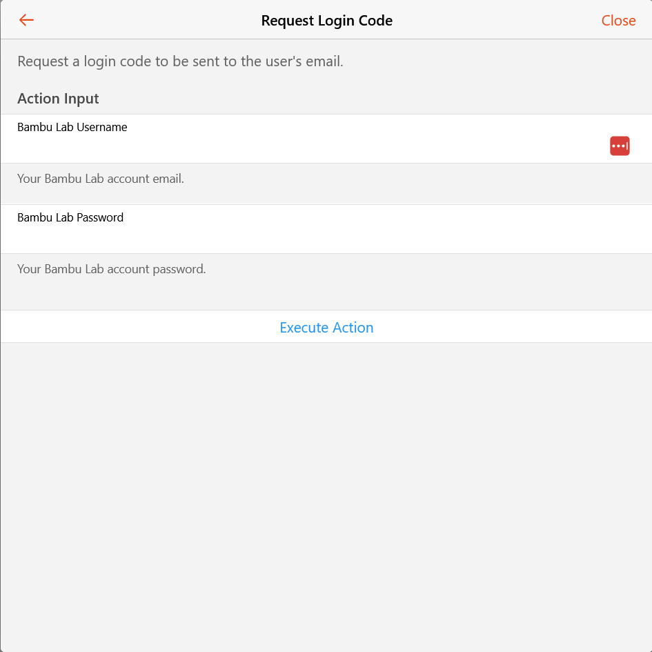

To obtain an access token, you can use the requestLoginCode and requestAccessCode actions available on the printer thing.
- Request Login Code: Use the
requestLoginCodeaction with your Bambu Lab username (email) and password. This will send a 6-digit verification code to your email address.

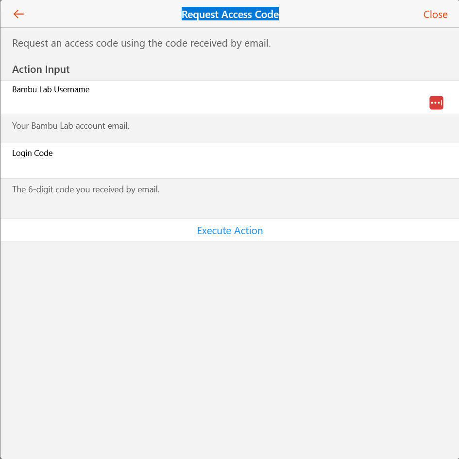

- Request Access Code: Once you receive the verification code, use the
requestAccessCodeaction with your Bambu Lab username (email) and the received 6-digit code. This will retrieve the access token and automatically update the printer thing's configuration with the newaccessCodeand set thehostnametous.mqtt.bambulab.com.
