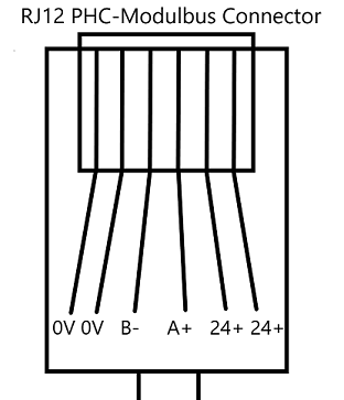

# Make a direct RJ12 connection
Connect a RJ12 plug with the RS485 adaptor and the power supply as follows.
| RJ12 like in picture below | The cores on the other side |
| 0V | 0V on power supply |
| B- | 485- on adaptor |
| A+ | 485+ on adaptor |
| 24+ | +24V on power supply |
