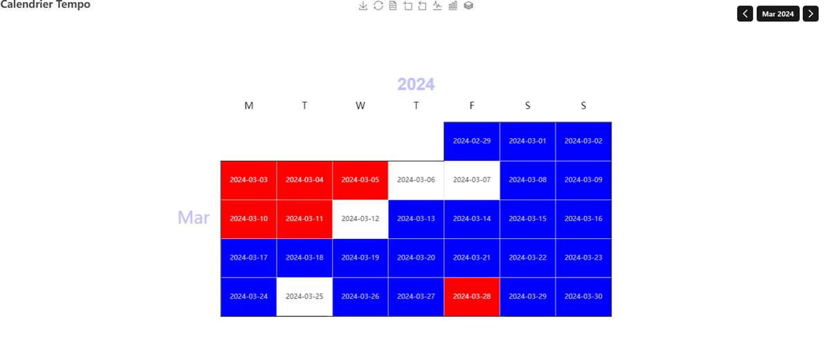

  • Connection to the RTE API to get Tempo Red/White/Blue calendar information.

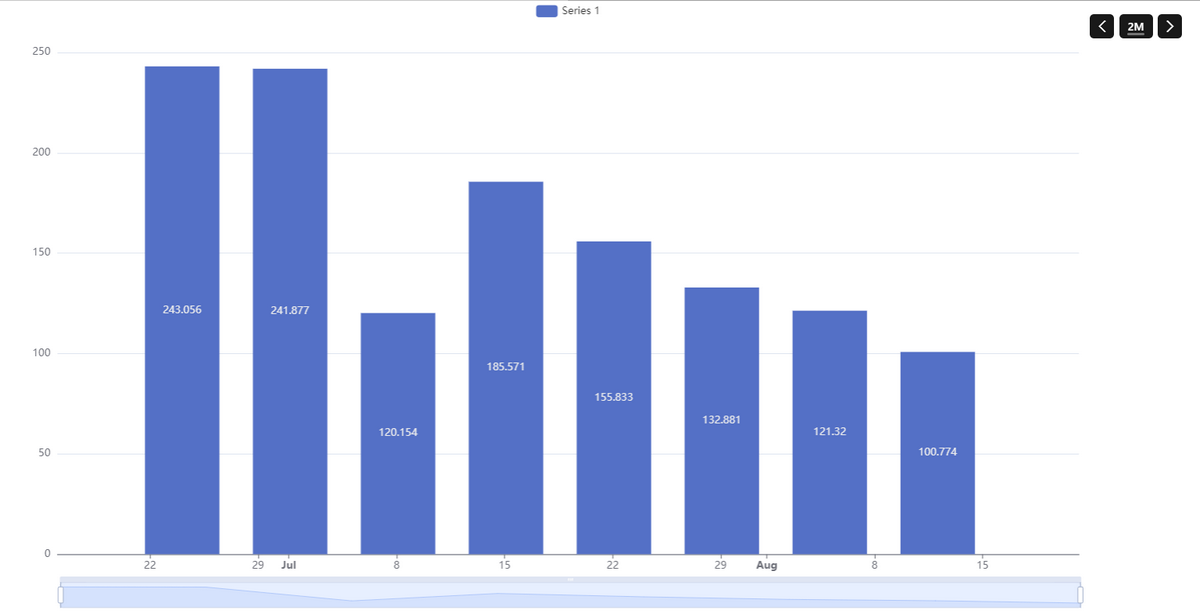

  • The weekly group will give consumtion information with week granularity
    Channel ID Item Type Description
    weekly#thisWeek consumption Current week energy usage
    weekly#lastWeek consumption Last week energy usage
    weekly#week-2 consumption Week -2 energy usage
    weekly#consumption consumption timeseries for weeks energy usage
    weekly#max-power power timeseries for max-power weekly usage

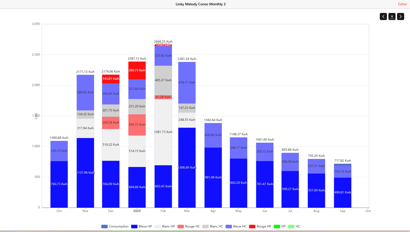

# Dynamic Thing Channels
The binding (as of openHAB 5.1.0) supports reading consumption indexes from the Enedis website.
This makes it possible to view consumption for different tariffs such as heures pleines / heures creuses or tempo.
To handle this, binding will create a new set of channels for daily, weekly, monthly, and yearly groups.
You will have two different sets of indexes:
  • Raw consumption indexes:
    These are the default indexes returned by Enedis. The naming uses base indexes, so there is no direct way to know which tariff each index corresponds to.
    Channels will be named as follows:
    consumptionSupplierIdx0, consumptionSupplierIdx1, ..., consumptionSupplierIdx9 consumptionDistributorIdx0, consumptionDistributorIdx1, ..., consumptionDistributorIdx3
    In France, the distributor is most often Enedis — they are responsible for distributing electricity on your network.
    The supplier is the commercial company with which you have a contract (EDF, TotalEnergies, etc.). This is where your specific supplier tariff is defined.
  • Named consumption indexes:
    To make things simpler, the binding also exposes tariff-named channels.
    For example:
    daily#heuresPleines, daily#heuresCreuses, daily#bleuHeuresCreuses, daily#bleuHeuresPleines, daily#redHeuresCreuses, ...
⚠️ Warning: Dynamic channels and indexes are currently only supported with the EnedisWebBridge.
Support for other bridges will be introduced later, once Enedis provides an API to access this data.

# Displaying Information Graph
Using the timeseries channel and the binding version in openHAB 5.1.0, you will be able to easily create a chart to show the consumption graph. To do this, you need to enable a timeseries persistence framework. Graph definitions will look like this:
TempoGraph
Sample code:
  future: false
  label: Conso Day
  order: "110"
  period: 2W
  sidebar: true
  dataZoom:
    - component: oh-chart-datazoom
        type: inside
  grid:
    - component: oh-chart-grid
        containLabel: true
        includeLabels: true
        show: true
  legend:
    - component: oh-chart-legend
        bottom: 3
        type: scroll
  series:
    - component: oh-time-series
        areaStyle:
          opacity: 0.2
        gridIndex: 0
        item: ConsoDay
        label:
          formatter: =v=>Number.parseFloat(v.data[1]).toFixed(2) + " Kwh"
          position: inside
          show: true
        markLine:
          data:
            - type: average
        markPoint:
          data:
            - name: min
              type: min
            - name: max
              type: max
          label:
            backgroundColor: auto
        noBoundary: true
        noItemState: true
        service: influxdb
        type: bar
        xAxisIndex: 0
        yAxisIndex: 0
  tooltip:
    - component: oh-chart-tooltip
        confine: true
        smartFormatter: true
  xAxis:
    - component: oh-time-axis
        gridIndex: 0
        nameLocation: center
        splitNumber: 10
  yAxis:
    - component: oh-value-axis
        gridIndex: 0
        max: "150"
        min: "0"
# Displaying Information Graph / New version with tariff
Using the timeseries channel and new version of the addons, you will be able to easily create a chart to show the consumption graph with tariff differentiation.
TempoGraph
Sample code:
  future: false
  label: ConsoMonth
  order: "9999999"
  period: Y
  sidebar: true
  dataZoom:
        type: inside
  grid:
        containLabel: true
        includeLabels: true
        show: true
  legend:
        bottom: 3
        orient: horizontal
        show: true
        type: scroll
  series:
        barGap: -100%
        gridIndex: 0
        item: ConsoMonth
        label:
          position: top
          show: true
        noBoundary: true
        noItemState: true
        service: inmemory
        type: bar
        xAxisIndex: 0
        yAxisIndex: 0
        color: "#1010ff"
        gridIndex: 0
        item: ConsoMonthHeuresPleinesBleue
        label:
          formatter: =v=>v.data[1]!="0"?Number.parseFloat(v.data[1]).toFixed(2) + "
            Kwh":''
          position: inside
          show: true
        noBoundary: true
        noItemState: true
        service: inmemory
        stack: total
        type: bar
        xAxisIndex: 0
        yAxisIndex: 0
        color: "#f0f0f0"
        emphasis:
          disabled: true
        gridIndex: 0
        item: ConsoMonthHeuresPleinesBlanc
        label:
            Kwh":''
          position: inside
          show: true
        noBoundary: true
        noItemState: true
        service: inmemory
        stack: total
        type: bar
        xAxisIndex: 0
        yAxisIndex: 0
        color: "#ff7070"
        emphasis:
          disabled: true
        gridIndex: 0
        item: ConsoMonthHeuresCreusesRouge
        label:
            Kwh":''
          position: inside
          show: true
        noBoundary: true
        noItemState: true
        service: inmemory
        stack: total
        type: bar
        xAxisIndex: 0
        yAxisIndex: 0
        color: "#d0d0d0"
        emphasis:
          disabled: true
        gridIndex: 0
        item: ConsoMonthHeuresCreusesBlanc
        label:
            Kwh":''
          position: inside
          show: true
        noBoundary: true
        noItemState: true
        service: inmemory
        stack: total
        type: bar
        xAxisIndex: 0
        yAxisIndex: 0
        color: "#7070ff"
        emphasis:
          disabled: true
        gridIndex: 0
        item: ConsoMonthHeuresCreusesBleue
        label:
            Kwh":''
          position: inside
          show: true
        noBoundary: true
        noItemState: true
        service: inmemory
        stack: total
        type: bar
        xAxisIndex: 0
        yAxisIndex: 0
        color: "#ff1010"
        emphasis:
          disabled: true
        gridIndex: 0
        item: ConsoMonthHeuresPleinesRouge
        label:
            Kwh":''
          position: inside
          show: true
        noBoundary: true
        noItemState: true
        service: inmemory
        stack: total
        type: bar
        xAxisIndex: 0
        yAxisIndex: 0
        color: "#00ff00"
        emphasis:
          disabled: true
        gridIndex: 0
        label:
            Kwh":''
          position: inside
          show: true
        noBoundary: true
        noItemState: true
        service: inmemory
        stack: total
        type: bar
        xAxisIndex: 0
        yAxisIndex: 0
        color: "#80ff80"
        emphasis:
          disabled: true
        gridIndex: 0
        label:
            Kwh":''
          position: inside
          show: true
        noBoundary: true
        noItemState: true
        service: inmemory
        stack: total
        type: bar
        xAxisIndex: 0
        yAxisIndex: 0
  tooltip:
        confine: true
        orient: vertical
        show: true
  visualMap: []
  xAxis:
        gridIndex: 0
        splitNumber: 10
  yAxis:
        gridIndex: 0

# Displaying Tempo Graph
Using the timeseries channel, you will be able to esealy create a calendar graph to show the tempo calendar. You will need for this to enable a timeseries persistence framework. Graph definitions will look like this
The resulting graph will look like this:
TempoGraph
Sample code:
  chartType: month
  future: false
  label: Tempo
  period: M
  sidebar: true
  calendar:
    - component: oh-calendar-axis
        cellSize: 10
        dayLabel:
          firstDay: 1
          fontSize: 16
          margin: 20
        left: center
        monthLabel:
          color: "#c0c0ff"
          fontSize: 30
          margin: 20
        orient: vertical
        top: middle
        yearLabel:
          color: "#c0c0ff"
          fontSize: 30
          margin: 50
  dataZoom:
        orient: horizontal
        show: true
        type: slider
  grid: []
  legend:
        show: false
  series:
    - component: oh-calendar-series
        aggregationFunction: average
        calendarIndex: 0
        coordinateSystem: calendar
        item: Linky_Tempo
        label:
          formatter: =v=> JSON.stringify(v.data[0]).substring(1,11)
          show: true
          smartFormatter: false
        service: inmemory
        type: heatmap
  title:
    - component: oh-chart-title
        show: true
        text: Calendrier Tempo
  toolbox:
    - component: oh-chart-toolbox
        presetFeatures:
          - saveAsImage
          - restore
          - dataView
          - dataZoom
          - magicType
        show: true
  tooltip:
        formatter: "{c}"
        show: true
  visualMap:
    - component: oh-chart-visualmap
        bottom: 0
        calculable: true
        inRange:
          color:
            - "#0000ff"
            - "#ffffff"
            - "#ff0000"
        left: center
        max: 2
        min: 0
        orient: horizontal
        presetPalette: ""
        show: false
        type: continuous
  xAxis: []
  yAxis: []
