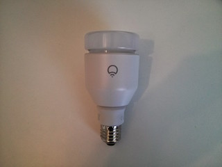

# LIFX Binding
This binding integrates the LIFX LED Lights (opens new window). All LIFX lights are directly connected to the WLAN and the binding communicates with them over a UDP protocol.
