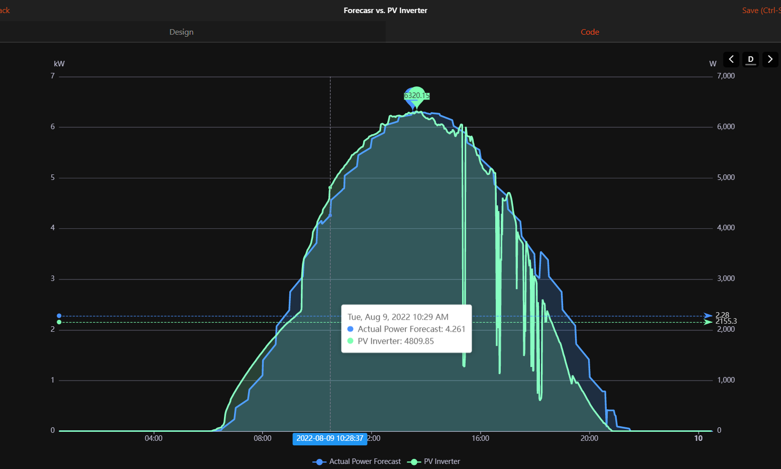

Display Power values of Forecast and PV Inverter items
Solar Forecast Power Chart

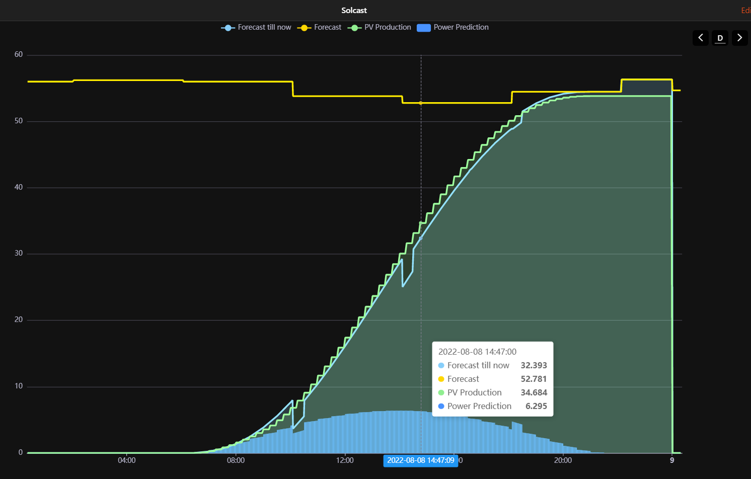

Display Energy values of Forecast and PV inverter items Yellow line shows Daily Total Forecast.
Solar Forecast Energy Chart
