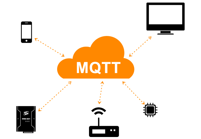

MQTT is one of the most commonly used protocols in IoT (Internet of Things) projects. It stands for Message Queuing Telemetry Transport.
It is designed as a lightweight messaging protocol that uses publish/subscribe operations to exchange data between clients and the server.

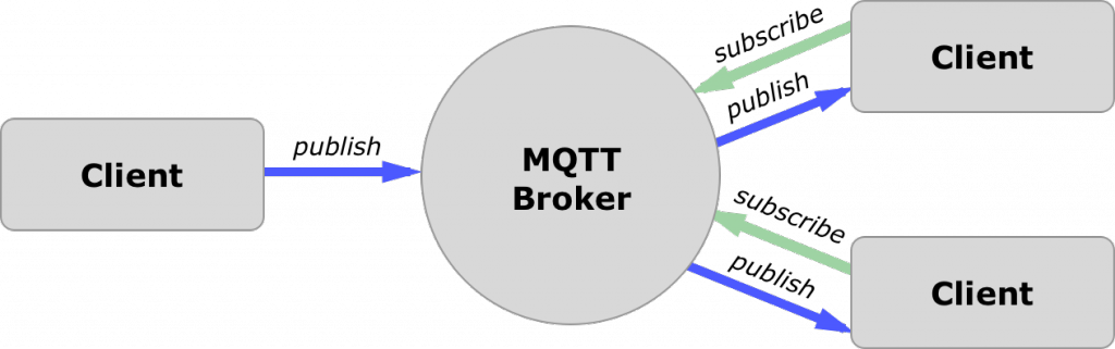

MQTT Architecture
MQTT servers are called brokers and the clients are simply the connected devices.
  • When a device (a client) wants to send data to the broker, we call this operation a “publish”.
  • When a device (a client) wants to receive data from the broker, we call this operation a “subscribe”.
Publish and Subscribe
openHAB itself is not an MQTT Broker and needs to connect to one as a regular client. You can use any of the freely available MQTT Brokers like Mosquitto (opens new window).
This particular binding allows to configure connections to brokers via openHAB Things, and configure channels corresponding to MQTT topics. This binding does NOT perform auto-discovery of available MQTT topics. Please check out the available extensions:
