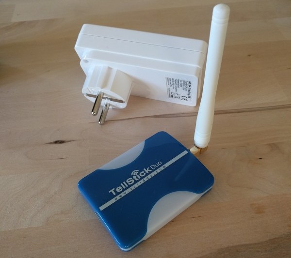

This is an openHAB binding for Tellstick devices produced by Telldus, a Swedish company based in Lund.
The original Tellstick focused on controlling 433 MHz devices like switches, dimmers and reading sensors from different brands. Many of the supported devices are cheaper and "low-end" and support have been made by reverse engineer the transmission protocols. All of these 433 MHz devices is one-way, so some versions of the Tellstick monitoring the air to keep the state of all devices.
The latest versions have also implemented Z-Wave as transmission protocol which open up for more robust transmission due two-ways communication.
