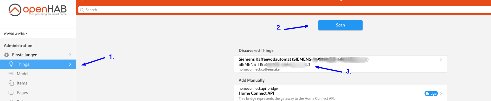

# Discovery
After the bridge has been added and authorized, devices are discovered automatically.

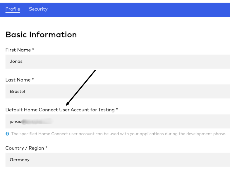

  2. Please make sure you've added your associated Home Connect account email at https://developer.home-connect.com/user/me/edit (opens new window). You should fill in your email address, which you use for the official Android or iOS app, at Default Home Connect User Account for Testing. Screenshot Home Connect profile page

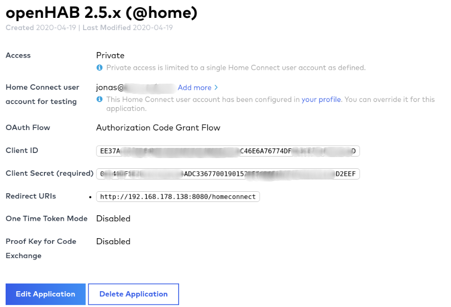

  3. Register / Create an application at https://developer.home-connect.com/applications (opens new window)
    • Application ID: e.g. openhab-binding
    • OAuth Flow: Authorization Code Grant Flow
    • Home Connect User Account for Testing: the associated user account email from Home Connect (opens new window)
      WARNING: Please don't use your developer account username
    • Redirect URIs: add your openHAB URL followed by /homeconnect, for example: http://192.168.178.34:8080/homeconnect or https://myhome.domain.com/homeconnect
    • One Time Token Mode: keep unchecked
    • Proof Key for Code Exchange: keep unchecked
      NOTE: You might get an error (403 - Forbidden) in case you entered a bare IP of your local openHAB instance. In that case, use your instance's hostname instead (e.g. for openhabian http://openhabian:8080/homeconnect) and try again.
  4. After your application has been created, you should see the Client ID and Client Secret of the application. Please save these for later.
Screenshot Home Connect application page

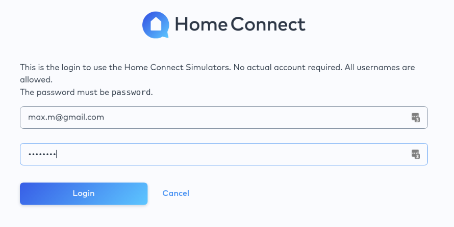

    • simulator: false

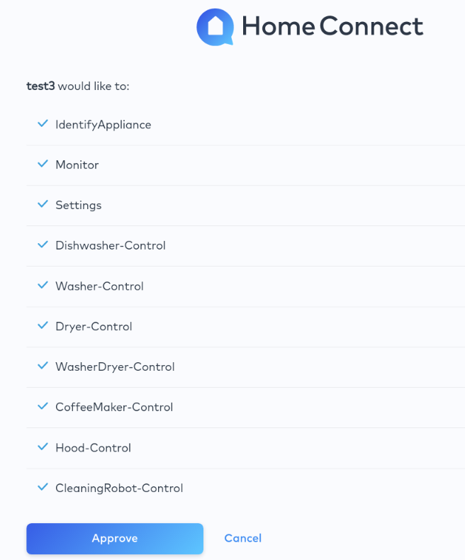

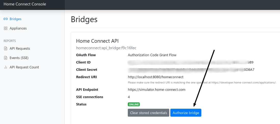

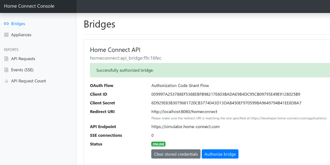

  5. Now navigate to the URL (Redirect URI) you've added to your Home Connect application in the previous step (2.3). For example, http://192.168.178.80:8080/homeconnect.
  6. Please follow the steps shown to authenticate your binding. You can redo this step every time. For example if you have authentication problems, just start wizard again. Screenshot Home Connect wizard page 1 Screenshot Home Connect wizard page 2 Screenshot Home Connect wizard page 3 Screenshot Home Connect wizard page 4
  7. That's it! Now you can use autodiscovery to add devices. Your devices should show up if you start a device scan in the openHAB UI.

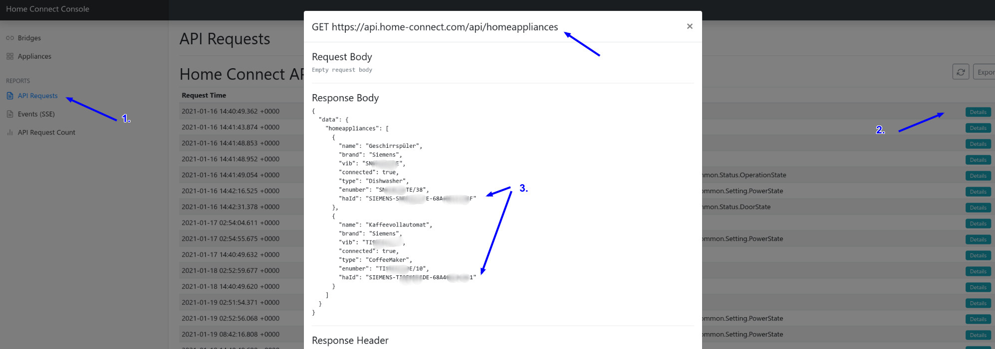

    Thing dishwasher dishwasher1 "Dishwasher"  [ haId="SIEMENS-HCS02DWH1-6F2FC400C1EA4A" ]
    Thing washer washer1 "Washer"  [ haId="SIEMENS-HCS03WCH1-1F35EC2BE34A0F" ]
    Thing fridgefreezer fridge1 "Fridge Freezer  [ haId="SIEMENS-HCS05FRF1-7B3FA5EB3D885B" ]
    Thing oven oven1 "Oven"  [ haId="BOSCH-HCS01OVN1-2132B6FA25BA21" ]
    Thing dryer dryer1 "Dryer"  [ haId="BOSCH-HCS04DYR1-3921C766AD5BAF" ]
    Thing coffeemaker coffee1 "Coffee machine"  [ haId="BOSCH-HCS06COM1-2140A8821AE7AB" ]
    Thing washerdryer washerdryer1 "Washerdryer"  [ haId="BOSCH-HCS06COM1-2140A8821AE7AB" ]
    Thing fridgefreezer fridgefreezer1 "Fridge/Freezer"  [ haId="BOSCH-HCS06COM1-2140A8821AE7AB" ]
    Thing hood hood1 "Hood"  [ haId="BOSCH-HCS06COM1-2140A8821AE7AB" ]
    Thing hob hob1 "Hob"  [ haId="BOSCH-HCS06COM1-2140A8821AE7AB" ]

# Home Connect Console
The binding comes with a separate user interface, which is reachable through the web browser http(s)://[YOUROPENHAB]:[YOURPORT]/homeconnect (e.g., http://192.168.178.100:8080/homeconnect).
Features:
  • Overview of your bridges and appliances
  • Send commands to your appliances
  • See latest API requests
  • See received events from the Home Connect backend
  • API request counts

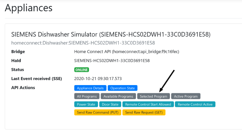

  1. On the physical device, select your desired program with the appropriate options.
  2. Open the appliance section of the binding UI (http(s)://[YOUROPENHAB]:[YOURPORT]/appliances) and click the 'Selected Program' button. Screenshot Home Connect wizard page 4
  3. Screenshot Home Connect wizard page 4 Copy the JSON payload. In a further step, this payload will be used to start the program.

# How to find the Home Appliance ID (HaID) of my device?
You have two options to find the right HaID of your device.
  1. You can use the openHAB UI and start a scan. Screenshot openHAB UI Scan for new devices
  2. You can use Home Connect binding UI. Please have a look at the first API request. Screenshot Home Connect Binding UI
