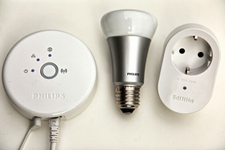

The Hue Bridge is required as a "bridge" for accessing any other Hue device. It supports the Zigbee Light Link protocol as well as the upwards compatible Zigbee 3.0 protocol. There are two types of Hue Bridges, generally referred to as v1 (the rounded version) and v2 (the squared version). The difference between the two generations of bridges is that the v2 bridge added support for Apple HomeKit and the CLIP v2 API see next paragraph. Both bridge types are fully supported by this binding.
Almost all available Hue devices are supported by this binding. This includes not only the "Friends of Hue", but also products like the LivingWhites adapter. Additionally, it is possible to use OSRAM Lightify devices as well as other Zigbee Light Link compatible products, including the IKEA TRÅDFRI lights (when updated). Besides bulbs and luminaires, the Hue binding also supports some Zigbee sensors. Currently, only Hue-specific sensors are tested successfully (Hue Motion Sensor and Hue Dimmer Switch). Please note that the devices need to be registered with the Hue Bridge before it is possible for this binding to use them.
