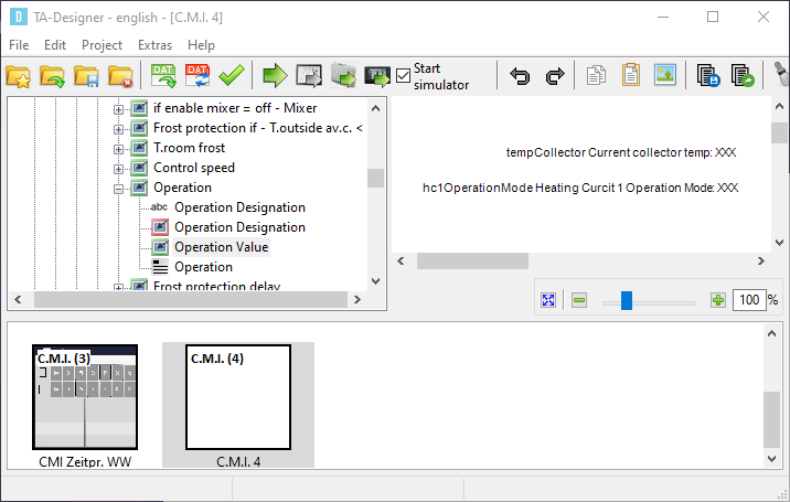

The "Schema API page" is a special schema page created via TA's TA-Designer application available as download on their web site. This page just needs to exist and be deployed on the C.M.I. but it dosn't need to be linked by the other schema pages you are using to control your TA installation.
All objects from this special 'API' page are automatically mapped as channels of this thing, so the labels of the objects on this page have to follow a specific schema.

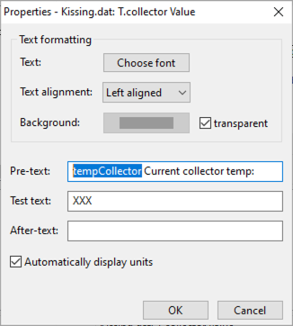

When adding objects to this page, the schema for the Object's Pre-Text field has to follow the schema <channelName> <channel description>:.
Maybe this screenshot shows it best:
The Text from the Pre-Text will be used to define the channel. The first word tempCollector (highlighted in the screenshot) will be used as channel name, so it has to be unique. Everything else till the final : will be used as channel description. Be sure to have at least 2 words in the Pre-Text as we need both - the channel name and a description. The binding will log an error otherwise. Also keep in mind: for the channel name we have to adhere to the openHAB channel name conventions - so just use letters and numbers without any special sings here. The type of the channel will be automatically determined by the type of the object added. Also don't forget the final colon - this is the separator between the label and the value. Without the colon the parser couldn't build up a working channel for this value.
The first sample is a sensor reading, but also the 'operation mode' of a heating circuit could be added:
In this screenshot you also see the schema page id - the parenthesized number on the bottom page overview, in this sample 4.

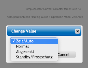

You might already have noticed that some state information is in German.
As I have set the Accept-Language-Http-Header to en for all request and found no other way setting a language for the schema pages I assume it is a lack of internationalization in the C.M.I.
You could circumvent this by creating map files to map things properly to your language.
If you want to see the possible options of a multi-state field you could open the schema API page with your web browser and click on the object. A Popup with an option field will be shown showing all possible options, like in this screenshot:
Please be also aware that there are field having more 'state' values than options, i.E. a manual output override: It has 'Auto/On', 'Auto/Off', 'Manual/On', 'Manual/Off' as state, but only 'Auto', 'Manual/On' and 'Manual/Off' as updateable option. You only set it to 'Auto' and the extension On/Off is added depending on the system's current state.
