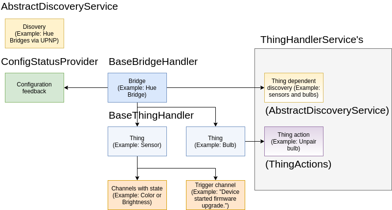

The overall structure looks like this:
TODO

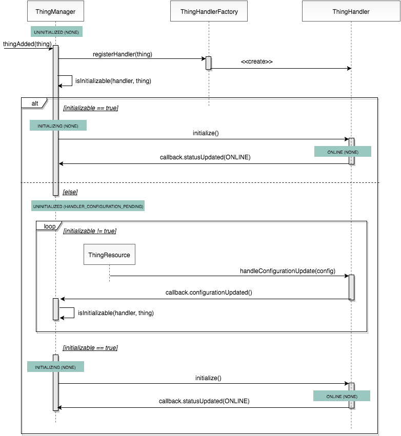

# Startup
The startup of a handler is divided in two essential steps:
  1. Handler is registered: ThingHandler instance is created by a ThingHandlerFactory and tracked by the framework. In addition, the handler can be registered as a service if required, e.g. as FirmwareUpdateHandler or ConfigStatusProvider.
  2. Handler is initialized: ThingHandler.initialize() is called by the framework in order to initialize the handler. This method is only called if all 'required' configuration parameters of the Thing are present. The handler is ready to work (methods like handleCommand, handleUpdate or thingUpdated can be called).
    The diagram below illustrates the startup of a handler in more detail. The life cycle is controlled by the ThingManager.
    thing_life_cycle_startup
The ThingManager mediates the communication between a Thing and a ThingHandler from the binding. The ThingManager creates for each Thing a ThingHandler instance using a ThingHandlerFactory. Therefore, it tracks all ThingHandlerFactorys from the binding.
The ThingManager determines if the Thing is initializable or not. A Thing is considered as initializable if all required configuration parameters (cf. property parameter.required in Configuration Description) are available. If so, the method ThingHandler.initialize() is called.
Only Things with status (cf. Thing Status) UNKNOWN, ONLINE or OFFLINE are considered as initialized by the framework and therefore it is the handler's duty to assign one of these states sooner or later. To achieve that, the status must be reported to the framework via the callback or BaseThingHandler.updateStatus(...) for convenience. Furthermore, the framework expects initialize() to be non-blocking and to return quickly. For longer running initializations, the implementation has to take care of scheduling a separate job which must guarantee to set the status eventually. Also, please note that the framework expects the initialize() method to handle anticipated error situations gracefully and set the thing to OFFLINE with the corresponding status detail (e.g. COMMUNICATION_ERROR or CONFIGURATION_ERROR including a meaningful description) instead of throwing exceptions.
If the Thing is not initializable the configuration can be updated via ThingHandler.handleConfigurationUpdate(Map). The binding has to notify the ThingManager about the updated configuration by a callback. The ThingManager tries to initialize the ThingHandler resp. Thing again.
After the handler is initialized, the handler must be ready to handle methods calls like handleCommand and handleUpdate, as well as thingUpdated.

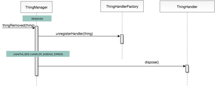

# Shutdown
The shutdown of a handler is also divided in two essential steps:
  1. Handler is unregistered: ThingHandler instance is no longer tracked by the framework. The ThingHandlerFactory can unregister handler services (e.g. FirmwareUpdateHandler or ConfigStatusProvider) if registered, or release resources.
  2. Handler is disposed: ThingHandler.disposed() method is called. The framework expects dispose() to be non-blocking and to return quickly. For longer running disposals, the implementation has to take care of scheduling a separate job.
thing_life_cycle_shutdown
After the handler is disposed, the framework will not call the handler anymore.
