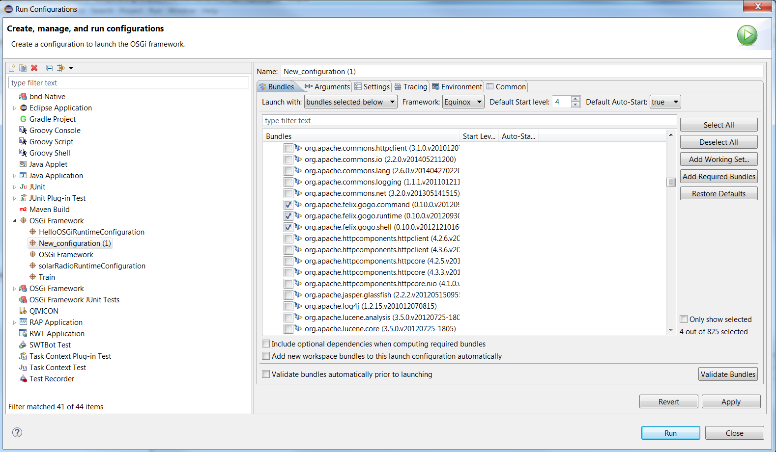

# Start Equinox Runtime from Eclipse
Go to "Run" -> "Run Configurations".
From the list in the left panel choose "OSGi Framework". Right click on it and choose "New".
After you've been created a new configuration, select the bundles that you need from the workspace.
Then make sure that the following bundles from the target platform are selected, otherwise the OSGi console will not be available:
org.apache.felix.gogo.runtime org.apache.felix.gogo.shell org.apache.felix.gogo.command org.eclipse.equinox.console
Click on "Add Required Bundles". Eclipse will resolve all dependencies of the bundles listed above and include new bundles to the configuration.
Click on "Validate Bundles" and make sure that "No problems were detected" is displayed.
You can start Equinox with the "Run" button.
