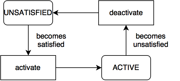

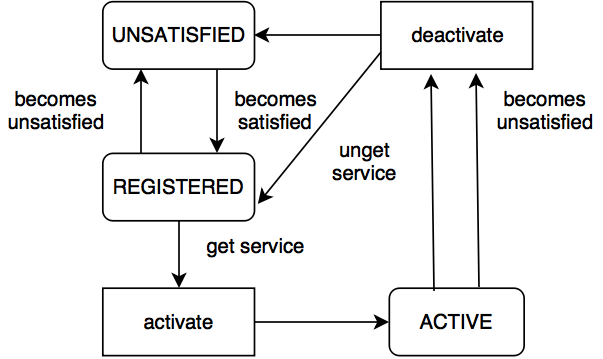

# Component Lifecycle
A component goes through several states in his lifecycle:
  • UNSATISFIED - initial state of the Service Component, after the bundle is started;
  • REGISTERED - temporary state. Only *delayed- components go through this state;
  • ACTIVE - the component is active and component instance is created.
Delayed component lifecycle Fig.1 Immediate component lifecycle Delayed component lifecycle Fig.2 Delayed component lifecycle
