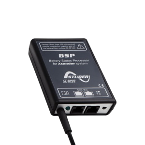

| bsp | For BSP that offers a highly precise measuring for Xtender, VarioTrack and VarioString systems | ![]() |

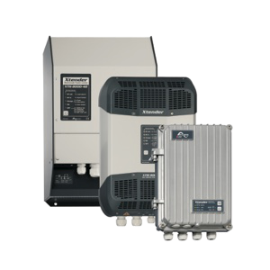

| xtender | For the Xtender models for system capacities from 0.5kVA to 72kVA that allow for the optimal use of available energy | ![]() |

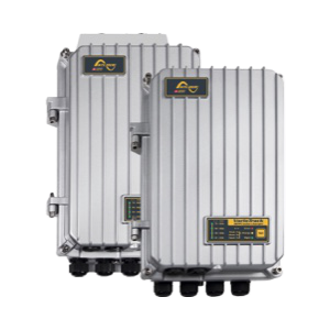

| variotrack | For the VarioTrack models of MPPT solar charge controllers for systems with solar PV capacity from 1 - 75kWp | ![]() |

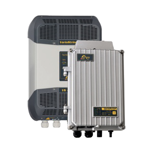

| variostring | For the VarioString models of MPPT solar charge controllers for systems with solar PV capacity from 4 | ![]() |
